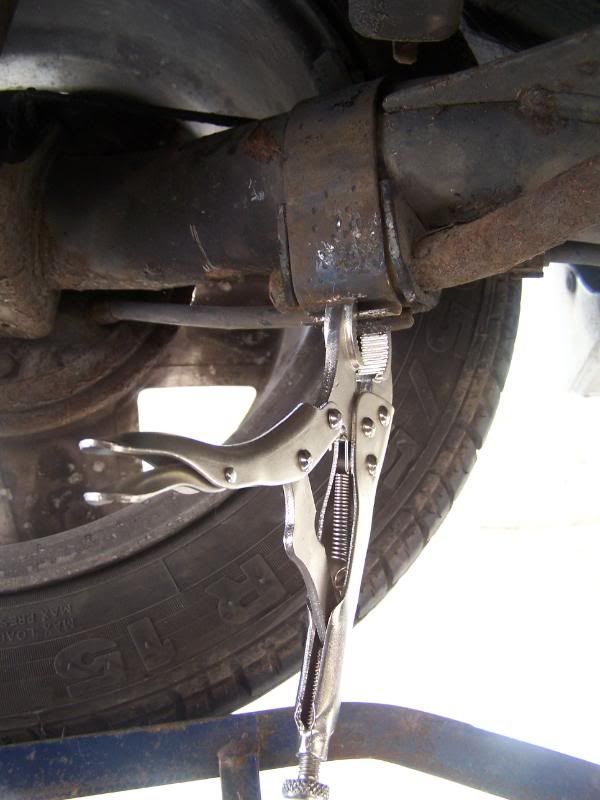

Next job on the list was to remove the rear anti-roll bar due to one of the clamp straps rusting through so was going to refurb it etc. Unfortunatly I rounded one of the bolt heads :( I was going to struggle to get the other one loose anyway as the fuel tank was in the way (had the car on ramps so I was going to jack am i right in thinking that the beam would have rotated to allow access???) ended up just fitting the replacement strap, checked over the rubber bushes and althougn they were slightly perished there was no play around the bar :)
broken strap-
nearly there-
And done-

eefy wrote: Image
Good to see the correct tools of Maul Grips, Screwdriver and hacksaw to hand. But where's the hammer??? You'd have a full tool set there if that was in shot! :D
eefy
Posts: 999
Re: Eefy's White Scala
Post by eefy »
It its mate just behind my head 5lb lump hammer!!!!!! well if its worth doing

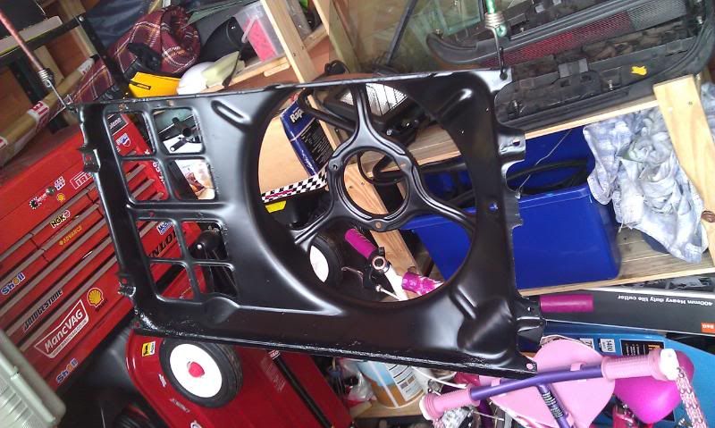

Next job tackled was the radiator cowl, thought this would just need a quick rub down some primer and a covering of satin black, fo got for a moment it will be coming out of a 19 year old car!!!!
As you will see there was hidden rust along the bottom and inside-
So hit it with a stiff wire brush and then some files to clear off the rust and give the visible parts a smoother finish, fortunately it was only surface rust, then it had a damn good clean-
During a liberal rust treatment-
Then it was cleaned again and degreased with some meths and had a coat of primer (I was planning to get 2 coats on but I ran out!!!!!)
So next day, finally got that second coat of primer on it-
Then it was the satin black 3 coats,-
And just to let you see the pitted surface where the worst of the rust was-
I also gave the fan and motor a quick clean-
Already for going back in, almost looks new :)
And back in
Much better:)
