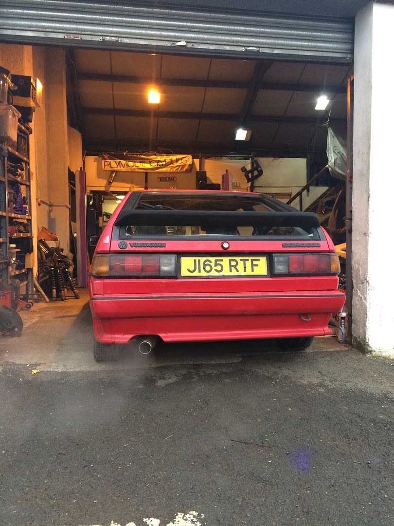

Surprisingly the brakes weren't seized and the tyres werent too bad! I drove it off the drive and got it recovered up-to my unit. After a power-washing the grime off of her she looked like this:
I got the car up on the ramps and it's solid underneath! Only thing that needs doing for a MOT is a track rod end and brake overhaul! I also need to replace the fuel filler neck as it's leaking.... I've been reading up on it and seems either a mk1 golf one with some modification should fit or a bmw e36 one with some mods. I'm gonna remove it this weekend and take a look. However this could have caused the said fueling problems a few years back!
I'm trying not to spend too much money or get too involved with this as my main project is the Corrado, but I can see myself getting carried away lol.
There's a few rust scabs on the roof gutters and the odd dent here and there but overall it's in pretty good condition!

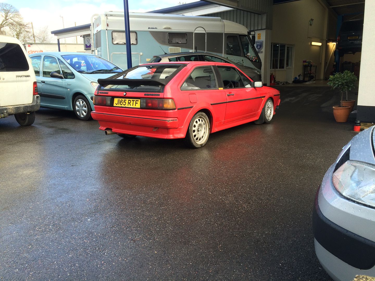

With the Corrado running out of tax, I decided it was time to take her off the road and start on the bodywork! So I started to prepare for the Scirocco's first MOT since 2013! Admittedly I started pretty late...a day before the MOT :/
The fuel filler neck was completely rusted through. I managed to get hold of a BMW E36 fuel filler neck for cheap so have "bodged" that on for now. I don't like how it fits so will replace it at somepoint soon.
Anyway, 10 mins before the MOT I had finished the fuel filler neck, swapped the front wheels over for two of my BBS RZ's that had decent tread, changed the front windscreen wipers and set off. Spent too much time faffing with the filler neck that I didn't get to check the bulbs!
Fortunately they were all fine and the rocco passed it's MOT! the brakes were a bit dodgy but have since bedded in after being sat around for over a year.

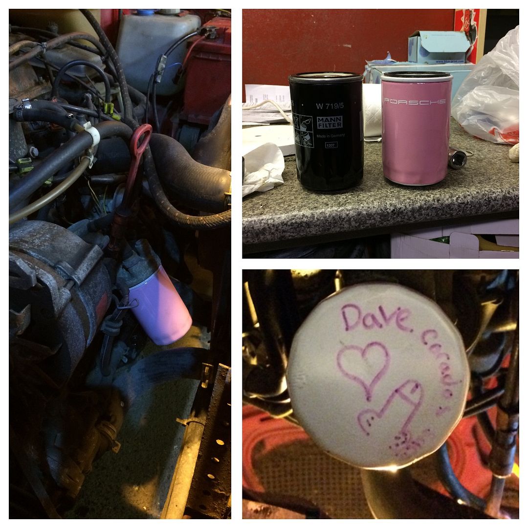

Drove it around over the weekend and then gave it a fresh service. Had a spare oil filter that a few mates had messed with last year that was intended for the Corrado, so chucked that on.
