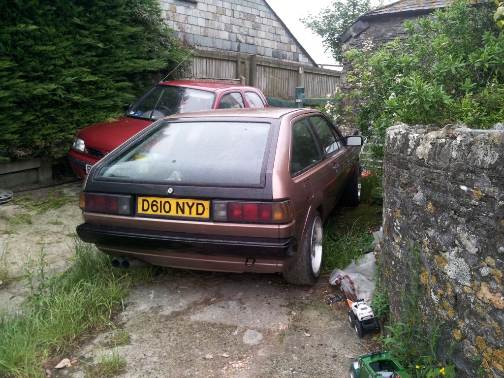

Horrible dilemma :(
to break or not break the scirocco.
she's currently sitting in the yard, needing a new exhaust and an intake manifold making for the carbs. otherwise all she needs is a little work on the arches, body kit refitting if wanted, a new bonnet and maybe a respray to get her looking great again. but mechanically its just the exhaust and intake mani (plus fitting the new engine mounts and gear linkage parts) :(
now, work has got me travelling all over (Oman, panama, gibraltar etc etc) i cant seem to find the time to get these last few bits finished. Add to that my current daily died and im looking at replacing it with a mk4 golf v6 4motion, and the idea of having the scirocco running for sumer as a toy/show car seems to be quickly going out the window :(
if i could sell her for 1k, id do it. no questions, id rather she went and was used properly. but i know thats an unrealistic price for a non runner. however, i keep being asked about parts; engine, box, interior, wings etc and could easily make a grand if i split it and still be left with a shell which could be scrapped for a bit of dollar or sold/given away for use on here.
what should i do :( if money is the objective, splitting her makes sense but i feel so guilty for it.

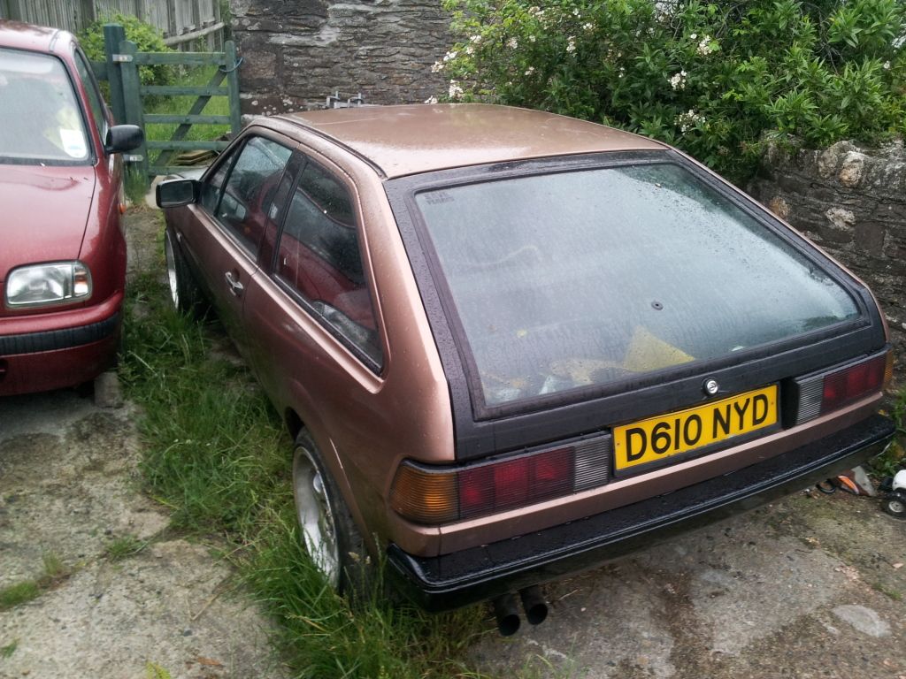

had the past 3 days to work on the car. lovely :)
exhaust manifold fitted
oil catch tank fitted
rear gearbox mount fitted
ground off rust from arches to see what metals left haha.
treated as much as i could with rust converter - even if its going to be welded. should keep the rust at bay.
some pics from today, with a damn cold start!
wassell
worst of the rust removed
done for the day

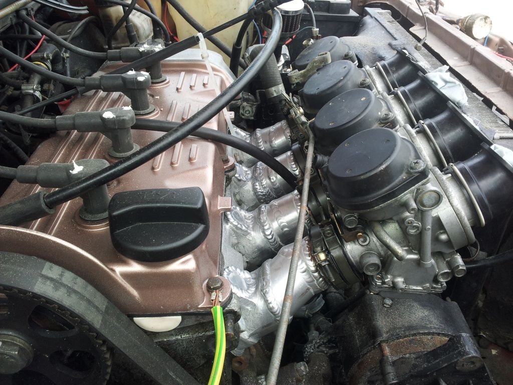

manifold being made by julian with the john deer green rocco. tubes aren't tacket yet, just getting the alignment sorted. will be very nice. :D

little more progress on the manifold. should be ready when i get home on the 27th, ill bosh it all back together and get some pics. now do i colour code my rocker cover or spray it black???

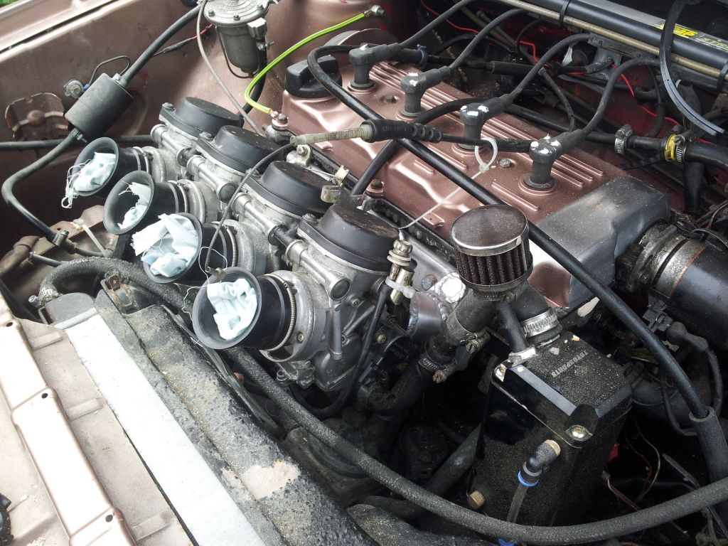

ok, small, but some progress has been made.
the manifold has been finished, rocker cover gasket changed and rocker cover sprayed/polished. internally i have re-fitted the 16v steering wheel.
just need to fit the alternator bracket, change the cam belt/tensioner, change the oil/filter, and sort some electrical gremlins then ill put her through an MOT.
hope i can get it working for summer!!
anywho, pictures :)

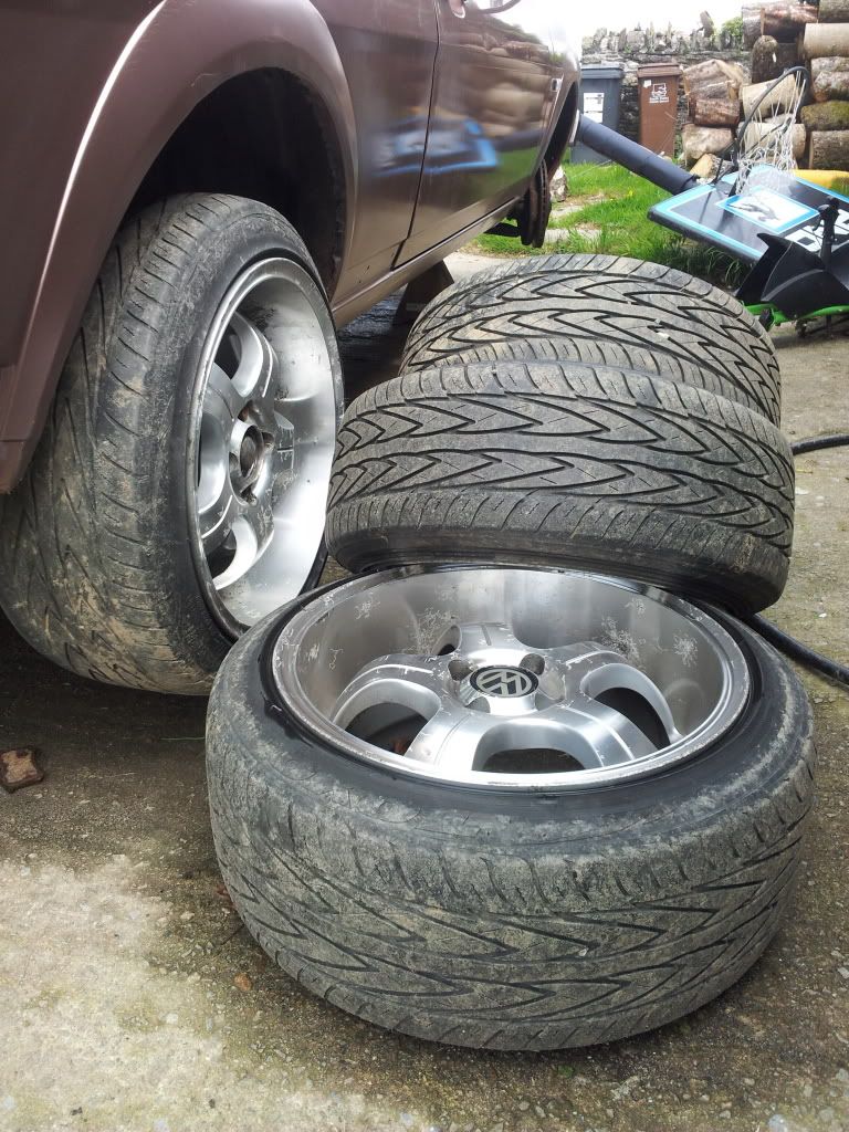

toying with the spare wheels. need a respray, probably in matt black. bit unsure about them.
oh, and the latest distraction
anywho, pictures :)

SHE"S ALIVE!!!
sounds incredible with the carbs, 4 branch and stainless system. really raspy roar. And by god does it have some throttle response! haha.
i'll see if i can get a short vid of her running soon. otherwise, shes going to a mates garage for some welding over the next few weeks, then its mot time! i've had to stow her away up the side of the house though for now.
happy days indeed!
