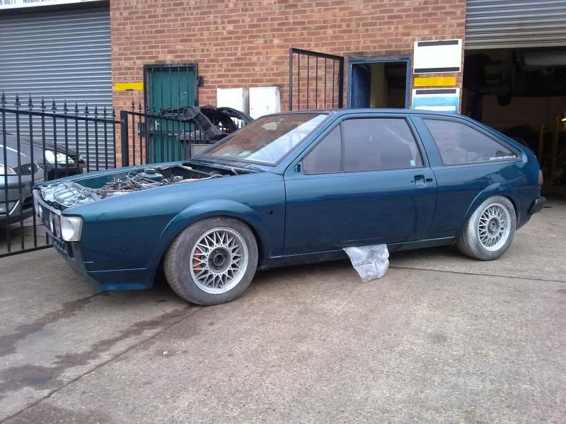

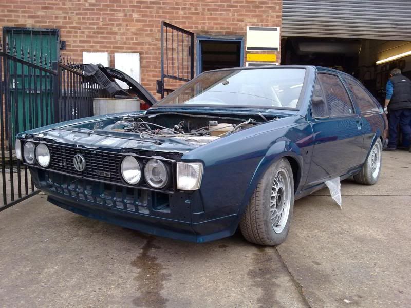

The wheels are et 16.3mm, and the hub adapters are 20mm = et -3.7mm on the car!
Now then. This uber low offset will work great on the rear, making these 7's sit exactly the same as the 8" splits (with 5mm spacer) did in the arch.
On the front, i'll end up with 5mm more poke than the 8's, Which isn't do-able
Unless i can find a pair of 15mm bolt on adapters, i'm screwed on the fronts
