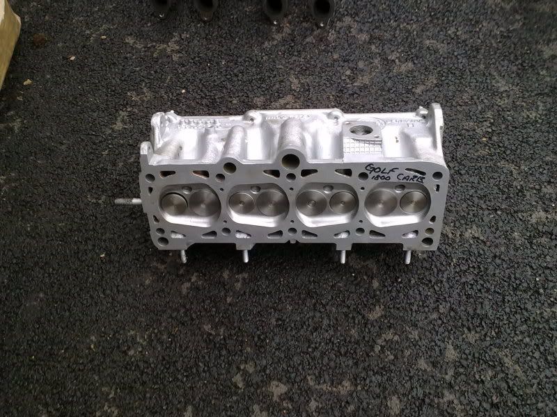

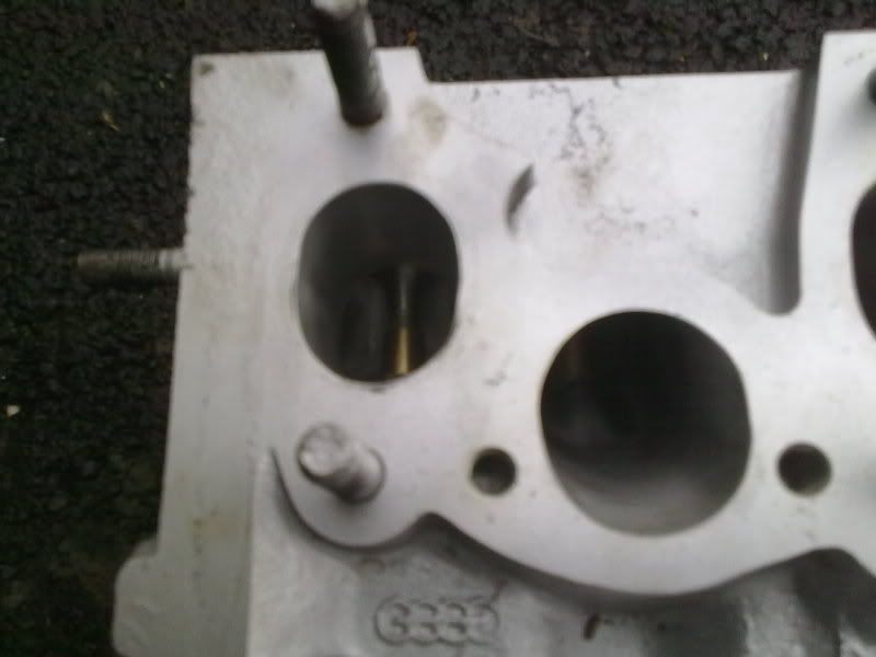

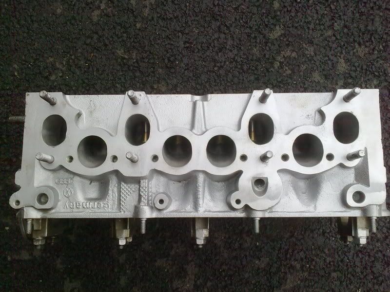

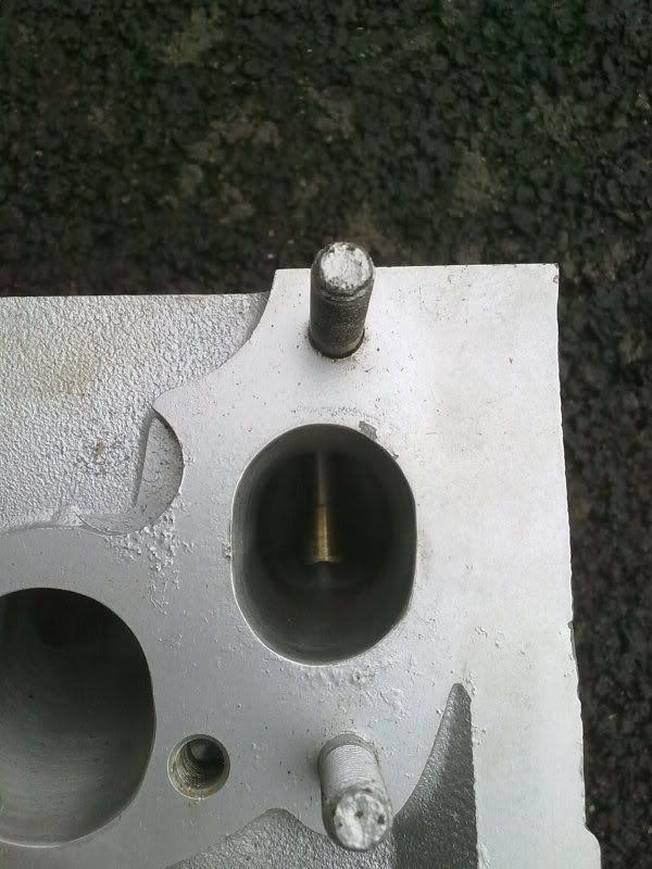

Are you looking for a head to go on the 2l block? Reason I ask is I notice you talk about the cost of getting a head done, and I have one that might suit. It has been ported and polished, exhaust valves are 33mm and inlet 40mm. I know this is standard for injection but not sure on carb heads. It is not required by me, got it in a job lot so am willing to do a good deal on it. Needs final build up with spings and tappets but these are supplied.

Home ported? There are a couple of things that make me think it's not a pro job. It's been painted rather than been caustic dipped and had the faces lightly skimmed to clean them up, and the port shapes aren't as even as some I've seen. Still looks pretty tidy overall though.
