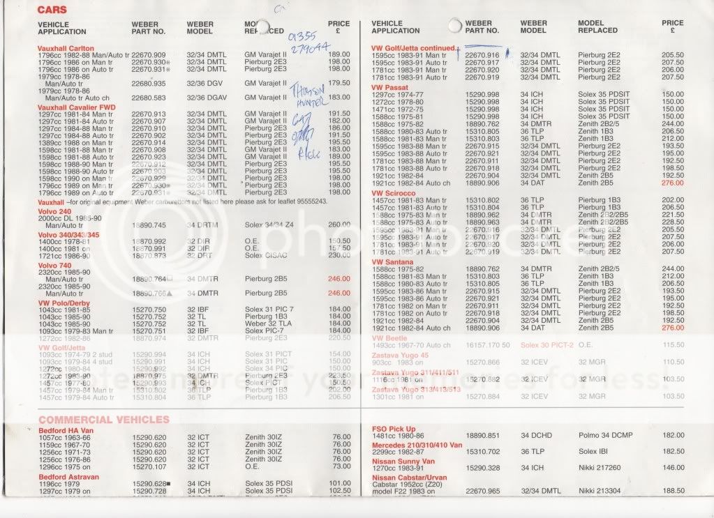

Re: Peirburg carb question
From Weber Direct Replacement Catalogue from a few years back but should still stand.
Hope it helps.
Right hand side halfway down.
Good Lock.
Hope it helps.
Good Lock.
Same pics on Volkzone with same reply.
A WEBER 34 DMTR.
A WEBER 34 DMTR.
