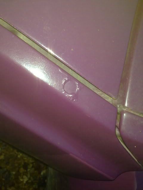

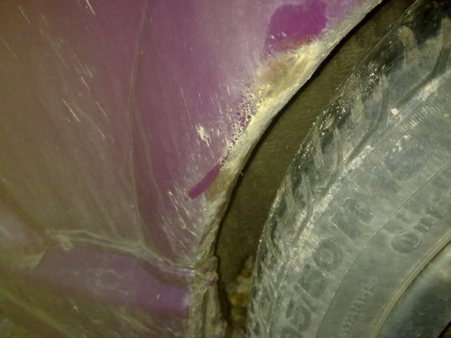

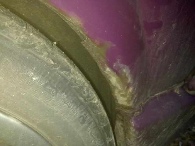

Starting with the worst of it; the rear arches

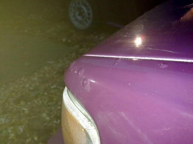

Same story with the one front wing too, the bubbles in the paint were trapped water! Down side of a 26+ year old car and running no arch liners :roll:
Lots of un-wanted rot poking through the paint work now, not happy but luckily I have repair panels and a spare wing to fix them up with :vcool:

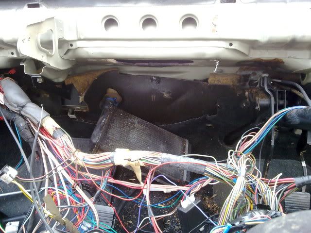

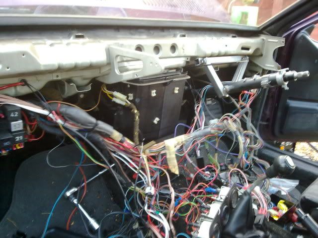

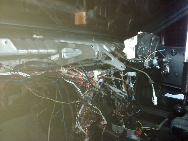

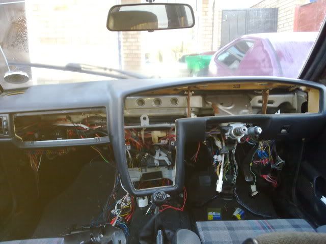

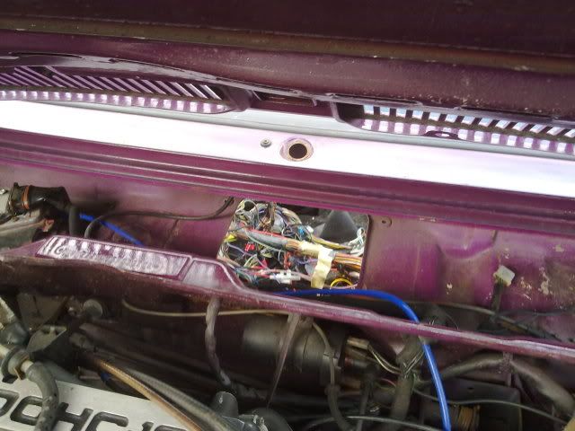

I've always fancied having a go at doing a full dash swap, so while i have got the car off the road i figured how hard can it be?? :whistle:
Out came the dash, i hate wiring, its taking ages to sort through it all and tidy it up!
Yup, thats not a Scirocco clock set either...

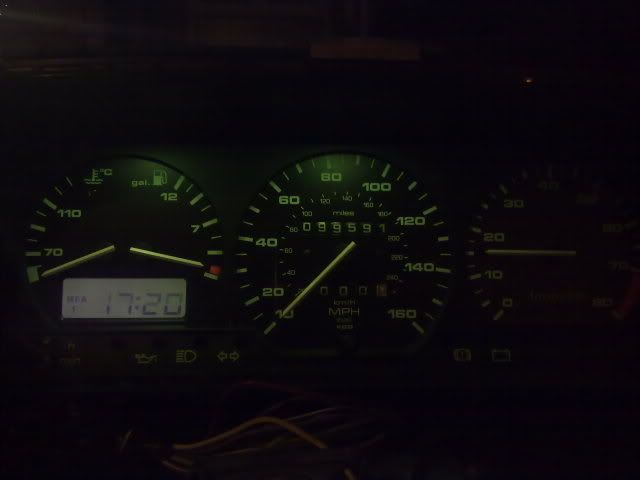

After days of reading wiring looms and fuse box break downs i managed to adapt the new clocks loom so it would plug and play with the 'rocco loom; it worked first time!!! :yahoo:
The headlight switch on the other hand is a right pain in the arse :ire:

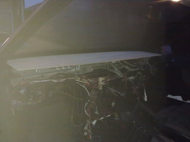

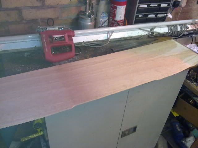

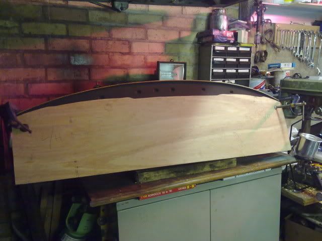

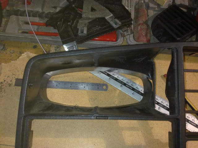

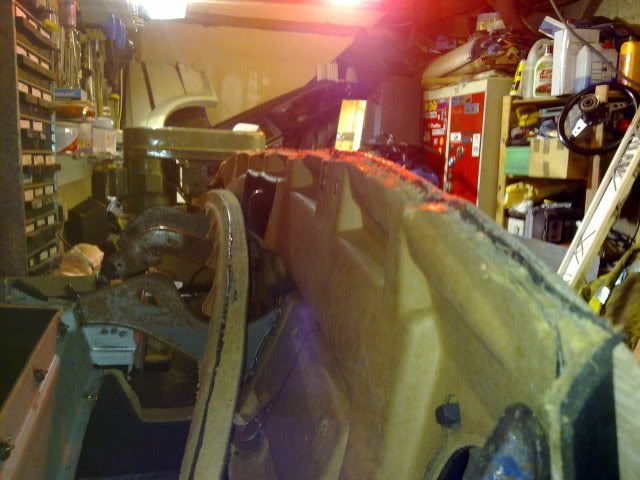

Anyway, with the dash out i made a template of the back of it
then made sure it was a good fit against the base of the screen
Clamped the template onto the new dash to see how much it needed fettling by....
quite alot was the answer!
Got it trimmed down (ignore the messy garage :shocking: )
but not had the chance to try it in place yet - was too dark tonight by the time i'd finished with cutting the dash to shape

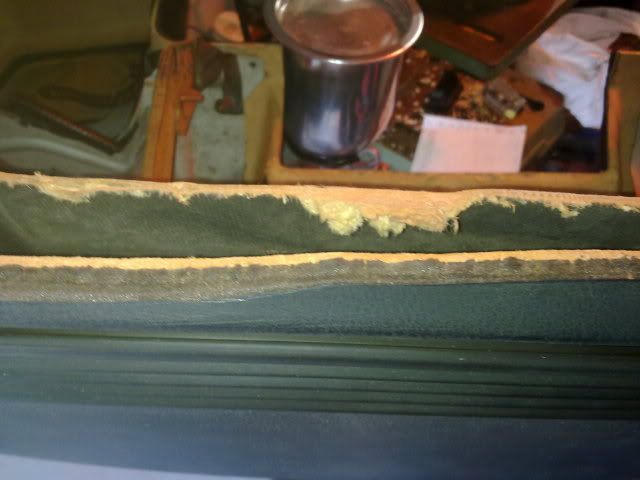

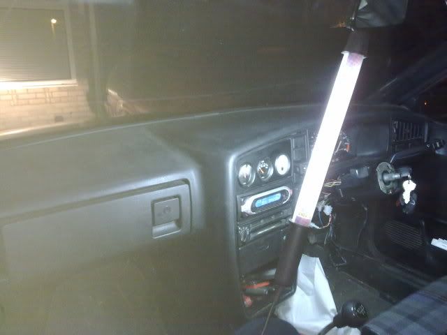

Managed to get some daylight hours in today and thought i'd have a look at how the dash looked
Needed another good 40mm trimming off the back of it, meaning there has been loads taken off now!
With it trimmed again it looks a much better fit
Only thing is it fouls on the steering column mount, quite badly infact
I'll be attacking that with an angle grinder; after i've designed and welded a new coloumn mount in place......
That'll be a nice 10 min job :scratch:

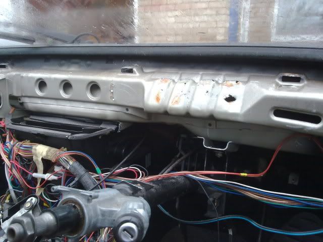

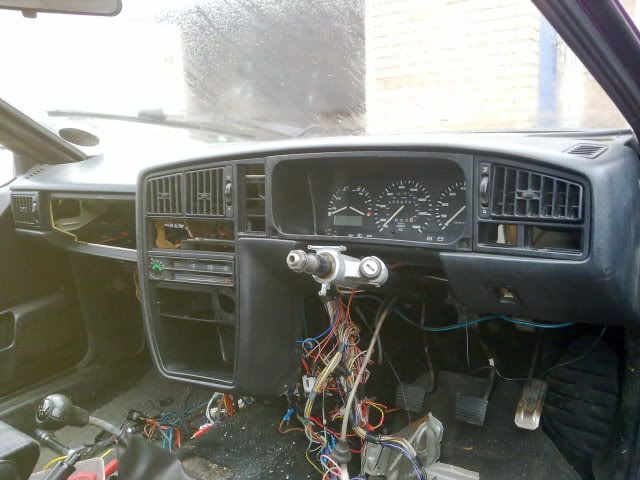

Managed to get a few hours in on the dash today, would of got more done but its bloody freezing!!
First task was to get rid of the standard steering column mount
Took absolutely ages!!!! Couldnt use a grinder with the screen still in place as knowing my luck i'll get sparks all over it and have to find a new one before i get the car back on the road :chortle:
Still not welded in a new mount, have the materials to do it with but with the temp hanging around 0 today i couldnt be bothered to freeze any more :swoon:
With the area cleared i took the chance to get the dash in and mounted, all i can say is what a pain in the arse it is to get everyting in properly until i was happy (ish!) with it!
Still absolutely loads to figure out, need to sort the lower centre console and then work out how the hell im going to get the dash and screen vents working properly :scratch:

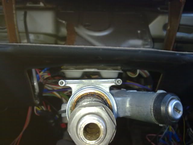

Managed to find a few hours to get some work done today. Always surprises me how little gets done in a few hours too :ire:

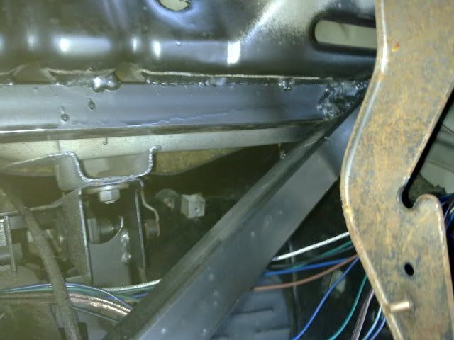

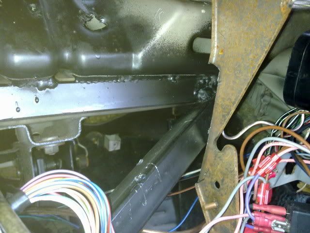

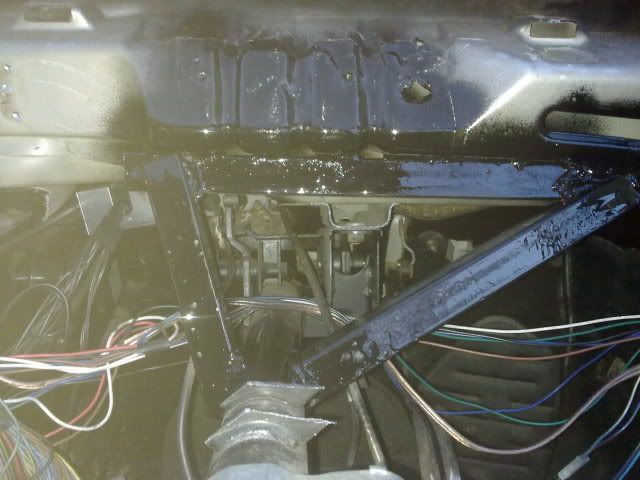

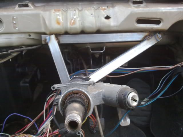

Took the dash back out of the car so i could get a new column support tacked into place
Kind of happy with it, there is no flex and the column in now nice and rigid again! Luckily the dash will hide it from view :hugegrin:
Still needs to be welded up properly but i need to make sure i still get clearance with the clocks and dash first

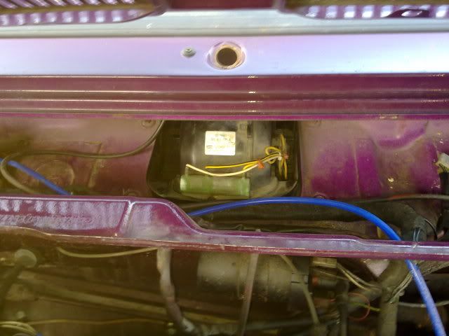

While the dash was out i took the chance to change the blower motor unit - i'd got the old one covered in overspray and it was squeeling while on 1 and 2 :ire:
Didnt fancy taking the heater matrix out as it means draining the fluid - doing it this way makes it bloody awkward changing the unis over tho!
New one fitted with plenty of swearing at wires and everything else in the car :chortle:
Got alot of wiring to sort through again, couldnt be bothered with it today as i was bloody freezing!

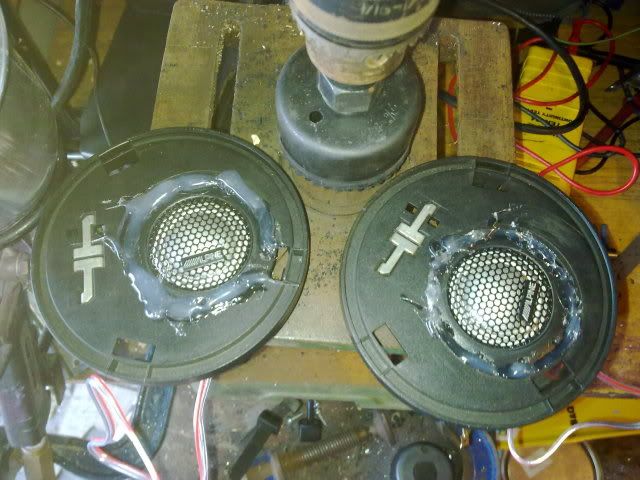

Had some new componant tweeters turn up during the week too, so while the garage was warm i got them fitted into the standard corrado dash speakers. Had to put a hole cutter through them first so i could glue the alpine aftermarket jobbies in place
Mounting them this way means i can still use the cover grills with no clearence issues. Had them wired up too and they sound pretty good! Just have to decide how i'm going to power the 10 speakers and the sub now :scratch:

Slowly getting through the dash installation, only doing a couple of hours at a time is dragging it out too mch for my liking :ire:
Managed to get the welding done on the new steering mount
Got plenty of weld in there so it deffinately wont be going anywhere :good:
Still need to grind the remains of the original mount away from the column at some point tho
Then came a massive schoolboy error on my part :blush:
Not at one stage did i actually put the dash back in place to make sure it cleared the new mount; I meant to but never got round to it
:stupid:
Typical, the dash support hits the box section before the dash is sat back properly!!!
Soon sorted that out tho
Meet mr cutting disc :vcool:

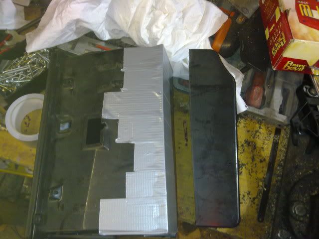

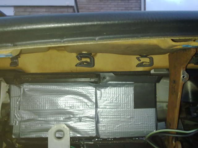

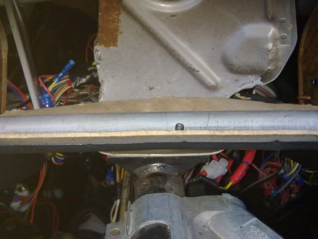

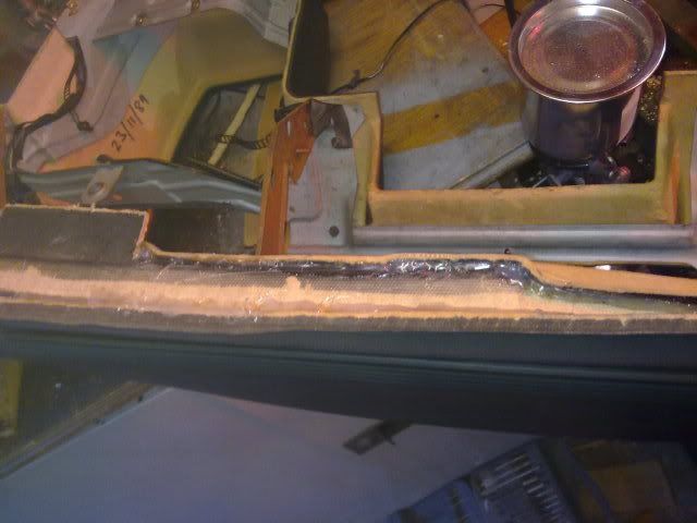

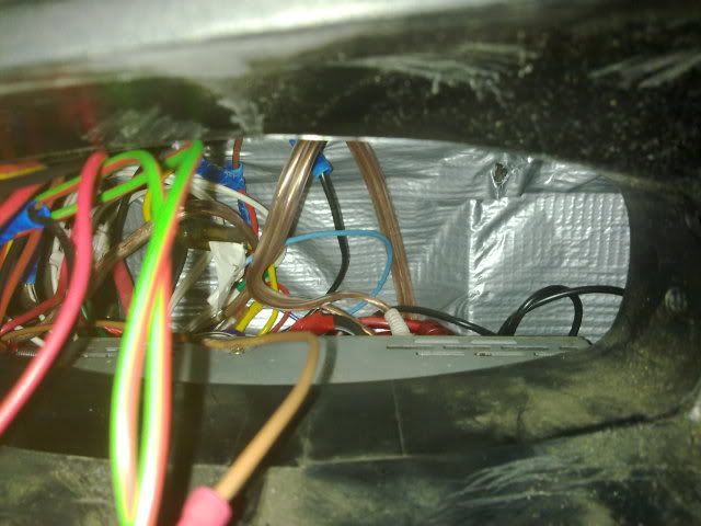

Before the dash was fixed in place i had a slight gap at the back of it to seal up and get air tight so i can use the dash vents properly
Was like this most of the way down the back of it, tho smaller in places! Took some thinking about but i finally settled on using some thin hardboard stuff from the dash off-cuts ive got in the garage, sealed in place with a hot glue gun!
Managed to get a good seal and the dash is now back to being air tight, tho once its back in the car i have this gap
Its where the dash sits above the top of the inner air chamber. Bit stumped on this one so im open to any suggestions!! :help:
Ignore the duct tape; its there as a temp measure while i tested the new blower motor (it works!!) and until i fix the dash vent outlet in place - ive a good idea on how im going to do this one tho :chortle:

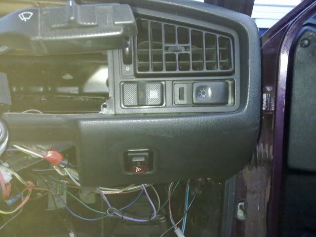

Also started to get the switches in place and sorted out, done the headlight, hazard and fog light switches
Also managed to work out which wire the clocks needs to have the brake warning light working properly, means its one less thing to re-home somewhere in the new dash!
Getting there but still a fair amount to work out and get sorted :swoon:

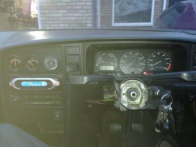

Good few hours work this afternoon and im much happier with progress now!

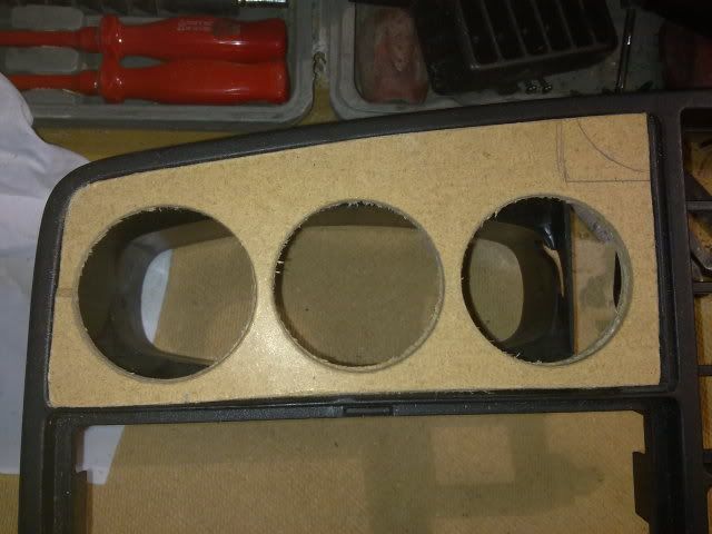

Decided i couldnt get the central dash vents working properly and after looking at chaps' dash conversion i thought i'd copy how the gauges were done :whistle:
Got the central vents removed and cut the divider and open/close mech out, gave me just about enough room to make a triple gauge panel.
Nice tight fit so i havent had to secure it in place, also i have covered it with black vinyl; not a bad match with the dash so its not bad!
Got the dash put together properly, used duct tape and cardboard ro seal up the screen vent, will come up with something a bit less 'bodgy' when i think of something :scratch:
Also found out its very tight on space behind the dash when the stereo is in
Took some slight persuasion to make it fit :hugegrin:
Looking good!

Did find out that when the clocks were in the speedo drive cable couldnt be plugged in to the back of it :ire:
Will have to look at adjusting the metal work under the screen at some point, shouldnt be too hard to figure out really!

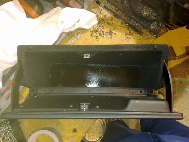

While i was on a roll i got round to looking at the glove box, didnt have to chop it down by as much as i thought i would have to
The tape is only there while the silicone goes off, tho knowing me it will be there for a while :lazy:
