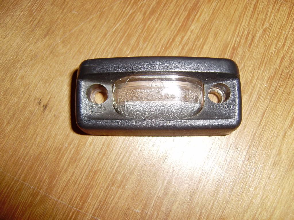

MacColl
Posts: 578
Re: Number plate light screws
Post by MacColl »
So I got the 6x 1/2 screws. They look small in relation to the lights I have salvaged off a Mk2 Polo. I suppose they tap into the tailgate itself so will still hold the lights in place. You can see the black cover that may or may not be used on top of the lens.. I have all this times two but the metal parts are not perfect. Hopefully the ones on the car will be ok.
DT1
Posts: 709
Location: Aberdeenshire
Post by DT1 »
Remember the small plastic washers for the screws. As you say, the tailgate holes are a lot smaller than the holes in the metal holder so don't worry.
A quick rub with emery paper and the holders will come up fine, it's really only the contact areas you need to worry about. You might want to do what I did and paint them, leaving only the contacts exposed.
