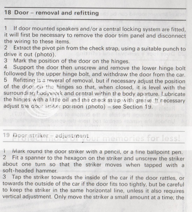

According to the manual it should be a five step job with a little adjustment IF required.
There is not really a lot of help in the manual.
It could be that yours sits a little bit different from the car the other was taken from and will require a bit of tweeking.

cheers, yeah I wasn't bowled over by the haynes this afternoon when I read that either!

Totally agree about the manual, on some jobs it is very poor.
I think it's just a bit of tweeking you need.
I don't know if any of our more learned members know of any differences in the doors.
