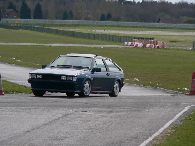

After two years of ownership of my 91 Scala, i have finally pulled my finger out and decided to splash some hard earned cash on her!
I bought her just coming up to two years ago off Sean AKA Mr Brown from the old forum. Absolutely loved the car and it had been kept in very good condition by previous owners. I have been tinkering a little for the past two years and have changed the wheels to late 1980's AMIL multispokes changed the plates to pressed one's, changed the front grille for a MK! grille with E30 headlights and the usual serviceable items.
