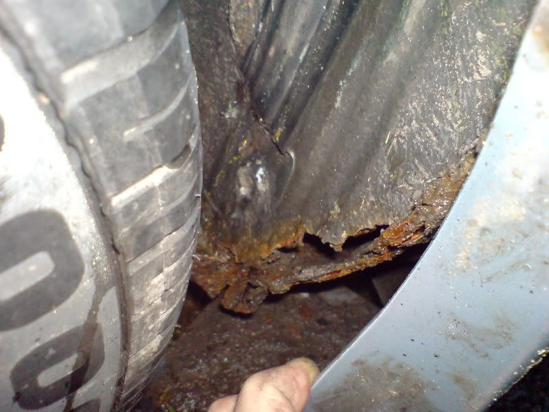

Easiest way is just to carefully feel around the wheel arches and front wings to feel for corrosion. A more thorough way is to remove all the screws around the lower edges of the side skirts and arch trims, ease them back and using a torch, check the general condition of the body underneath.
Doing it this way, you wont need to disturb the body kit adhesive, and once youve checked, you just refit the screws and everythings back as it was. The body kits do tend to hide alot of corrosion on earlier models.
A front wing with the plastic arch removed.
Behind the rear arch trim.

No problem Paul, fingers crossed yours is ok. I might try and put something together for the FAQ section about rust trouble spots.
