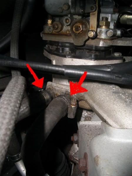

Well no luck with VW. Here is a couple of pics of the hose I mean in case anyone has any ideas..
This is where it fits to the car.

So all you really need is something like this then ......
http://www.samcosport.com/uk/rp_u-shape_hose.asp

Thanks for the link PeteGLi I ordered a hose and it fits! I did not mange to test it with the car running as it was raining again.
I ordered it from Merlin Motorsport from the internet £11.37 ex VAT, they do a lot of bits, they even sell VDO gauges if anyones after a new one.
