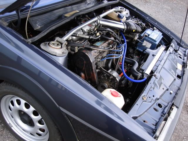

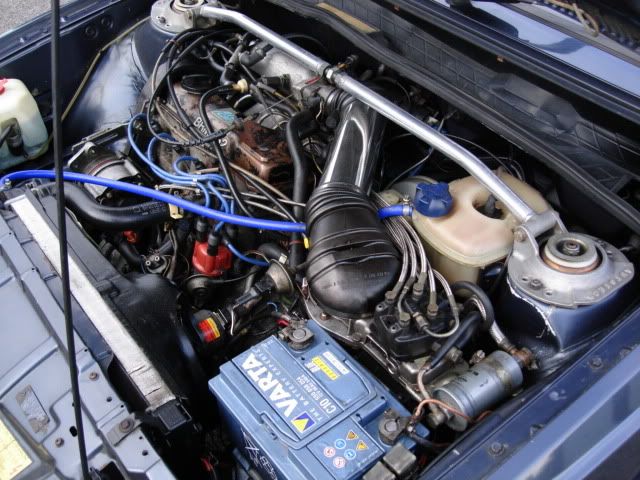

But at the end of the day this is the most important part of the Beast - it's Heart.
18 years on this is still my favourite and by far the most entertaining to drive. Tunnels are a particular joy......RWOAAAAAAAAAR!

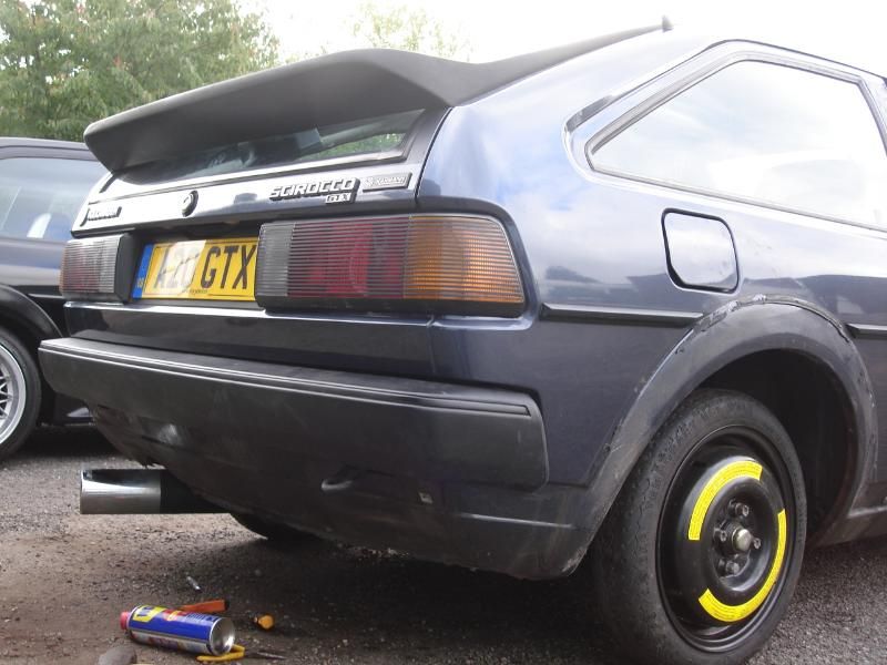

SORN since 1 June and looking even more sorry for itself today............
got to sort that stance out...................

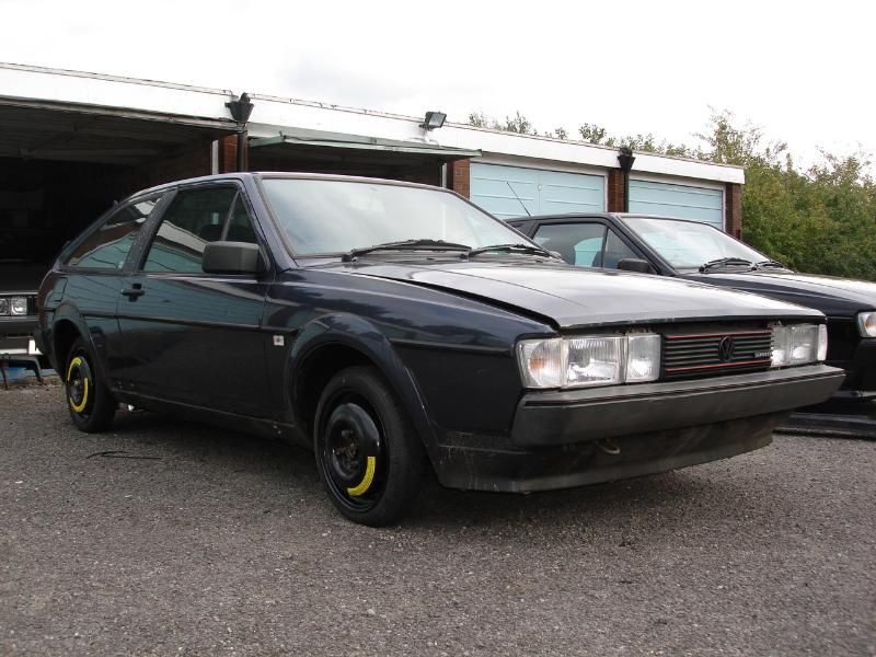

REALLY missing driving this one but after a lot of thought (even drafted out a for sale advert.........) decided to take the leap and get rid of the bodykit.

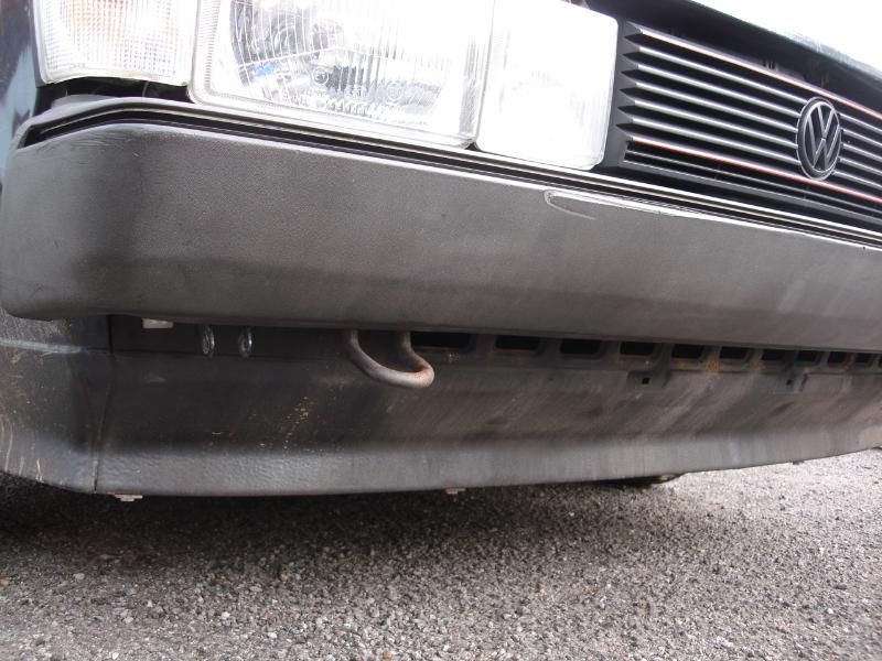

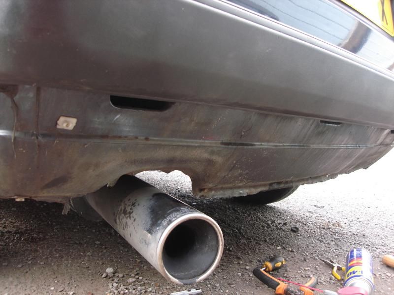

also fitted a new rear bumper - it's another bit of the former Throbbemobile in fact.

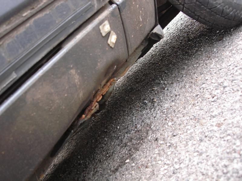

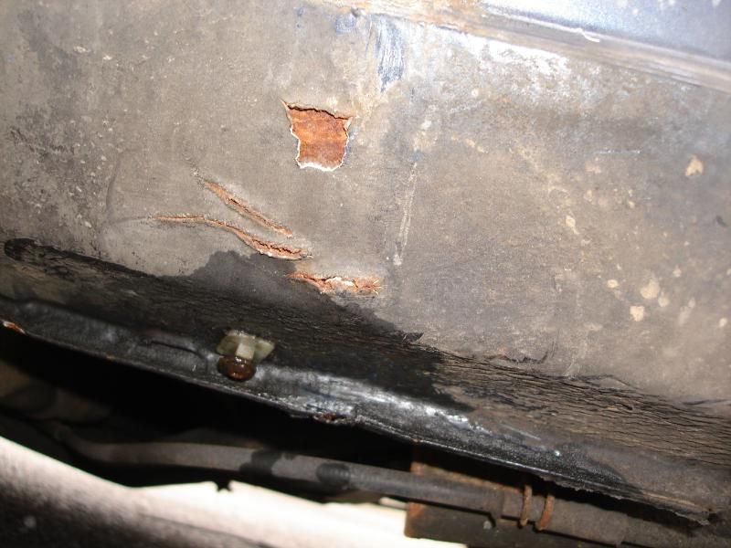

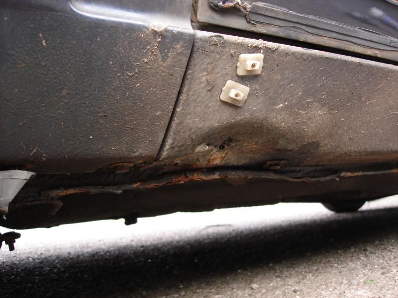

and pleasingly NOT too bad underneath the kit - bit of rustproofing applied to the crusty bits.

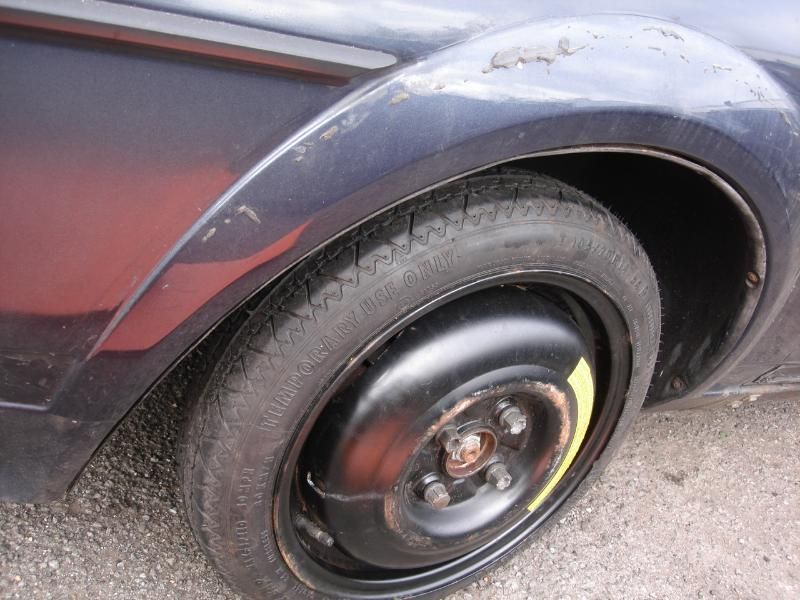

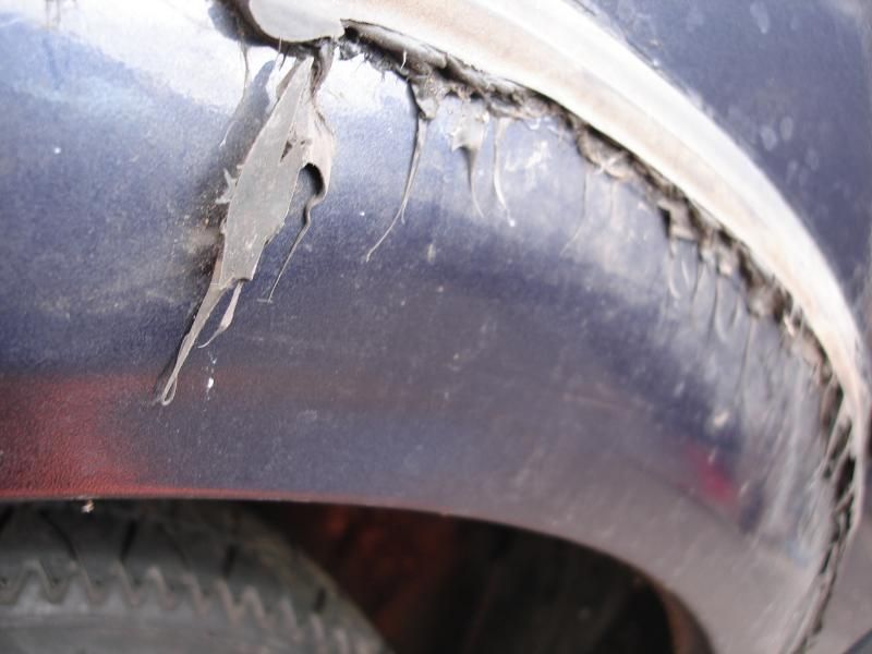

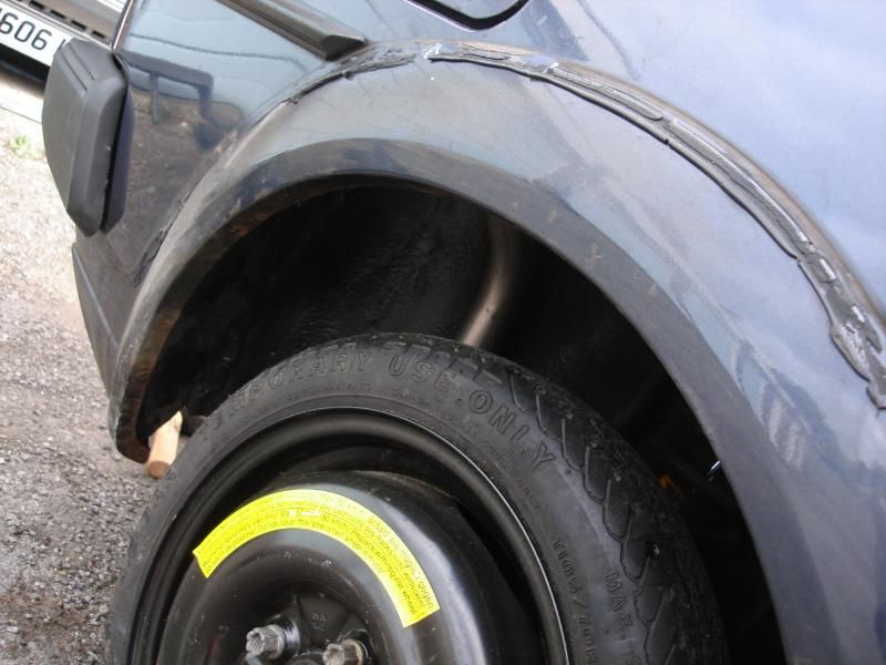

arches pretty sound, near side rear shows evidence of previous not so thorough bodywork repar, two small dents.

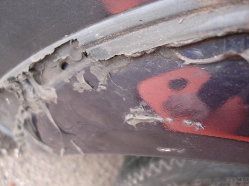

front panel good ok, rear a bit scabby - nothing that can't be repaired.

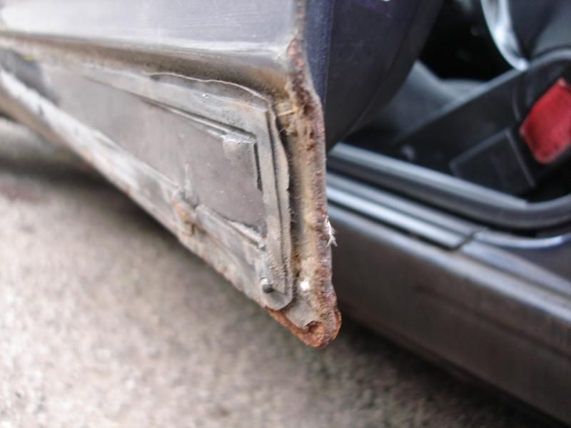

sloppy jacking tactics apparent on front of sills with kit off.
nearside door and rear ns sill

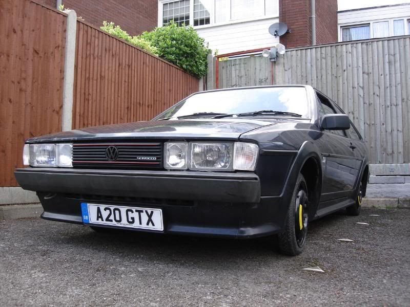

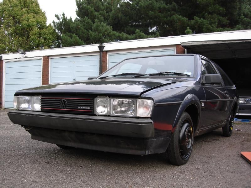

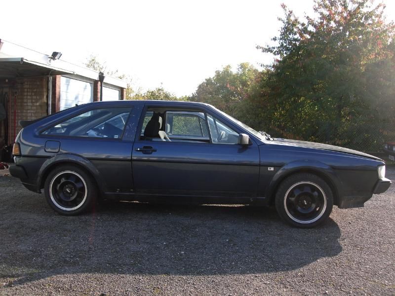

So, going to go for a non kit look with this - not aware of any helios cars without the kit and even though i am above all a GTX fan have got the black car to keep the 'XTRA spirit alive!
Reason? just got to like the look of the GTL slammed on the Castellets and reckon on a similar 'is it factory or is it modded?' look for this with a nice period but not too wide set of wheels.

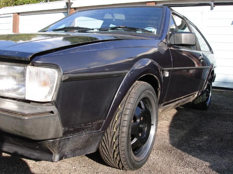

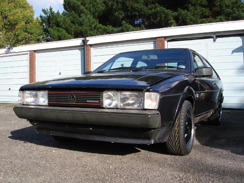

Bit more rustproofing and removal of bodykit kit gunk in advance of winter and decided to fit these today.

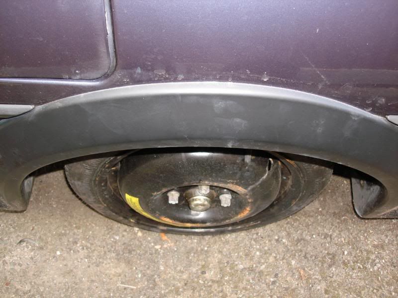

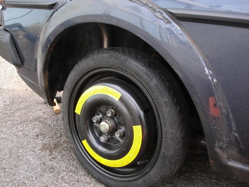

Acquired off ebay, tricky to come by ATS 6 x 15 cups that previous owner had self restored. HAD been saving them for the Mk1; if the other set of 70's delights rims dont work on that car then these will go on the '81.

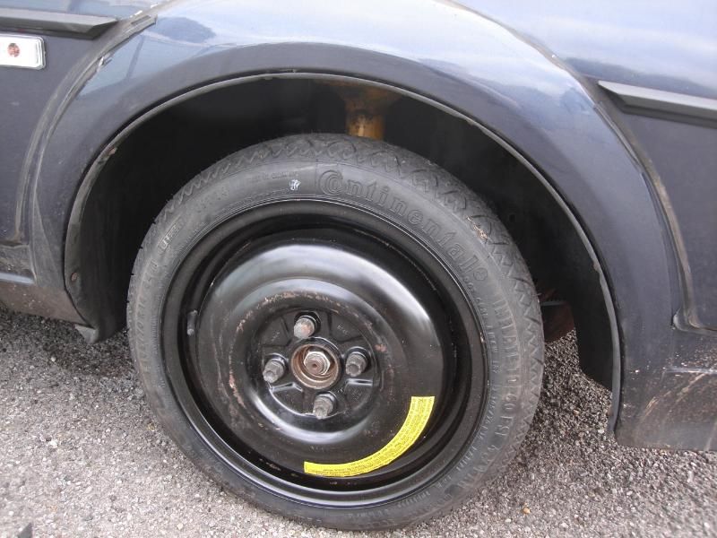

In the meantime, add some lovely new Toyo Proxes T1R's and the space saver look for the BRM is banished for good!
Not sure if I will stick with the black/silver look for them longterm on either this or the Mk1 if they get switch across but happy enough for now and BRM now safely garaged up for winter too.

Re: A20 GTX - Where it all began
very nice work :D
does the colour match up? (if you polish it nicely)
or will it need spraying?
cheers
Ben
cheers
Ben
yes - where original the paint matches . The car has had partial and not very good paint jobs under pre-2005 ownership and is destined for a complete respray when i raise the funds, just want to do as much of the prep work/clean up as possible and didnt want send it to painter without REALLY knowing the state of the arches.Rocco Ben wrote:very nice work :D

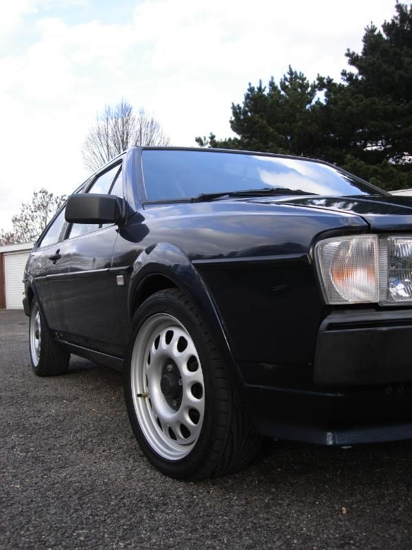

happiness is a set of G60's................
- Funky Diver
- Posts: 1175
- Location: Darlington
Neer been one for steel wheels in general... but I do really like those G60's.
I take it by their very nature they will fit 280mm calipers under them?
- Posts: 24
- Joined: Fri Mar 06, 2009 7:46 pm
- Location: Nottingham
Have to say it does look better on the g60's than the ATS'.
Funky Diver - yes 280's will fit under these wheels
