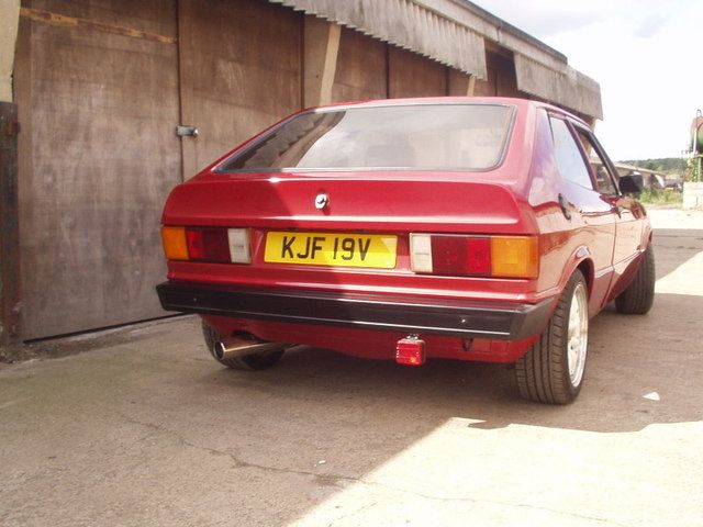

the question was 'what is the best offset to run on a 6X14 wheel. the answer is that the 'best' offset to run is that of factory. Now, since Mk1's were never originally specified with a 14" wheel logic would dictate that you run a similar offet to the 14" wheel from a Mk2, as they are exactly the same track and suspension arrangement, the difference between the two cars being a larger body grafted onto the A1 chassis.
The wheels in the pic above are simply marvelous and stick to a more or less factory offset (from memory they are ET 35) -you can tell from the way that they sit in the arch. They handled very well, to echo Mike above, with no tramlining or tourque steer (the car above is running a 2.1 8 valve, no more heavier an engine than standard really).
I've been through the running of hooge wheels and very very low cars, and at the risk of sounding like a fart, i can honestly say that I think a Scirocco handles the best when sticking closely to a factory set up but with a mild lowering and lower struct brace. Of course, people out there are absolutely entitled to disagree with me and throw rotten fruit etc. Looks are a differnt matter, do you want to drive your car or pose in your car and polish it? both are equally valid in my opinion and are done for different reasons. The car above is a compromise between those extremes.
So, to return to the question, the best offset for a 14" wheel on a mk1. Try a set of 6x14" Avus wheels from the mk2 Scala but beware if you have the early Girling calipers on the front, as the Avus wheel will not clear these calipers, this may be the same for other wheels. Later 'VW11' floating calipers on the Mk1 pose no wheel fitment problems.
