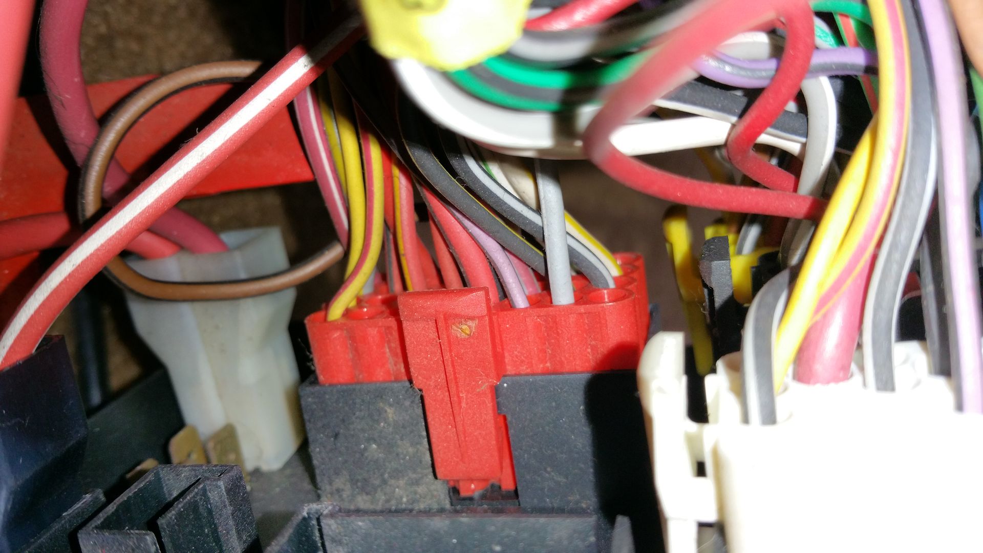

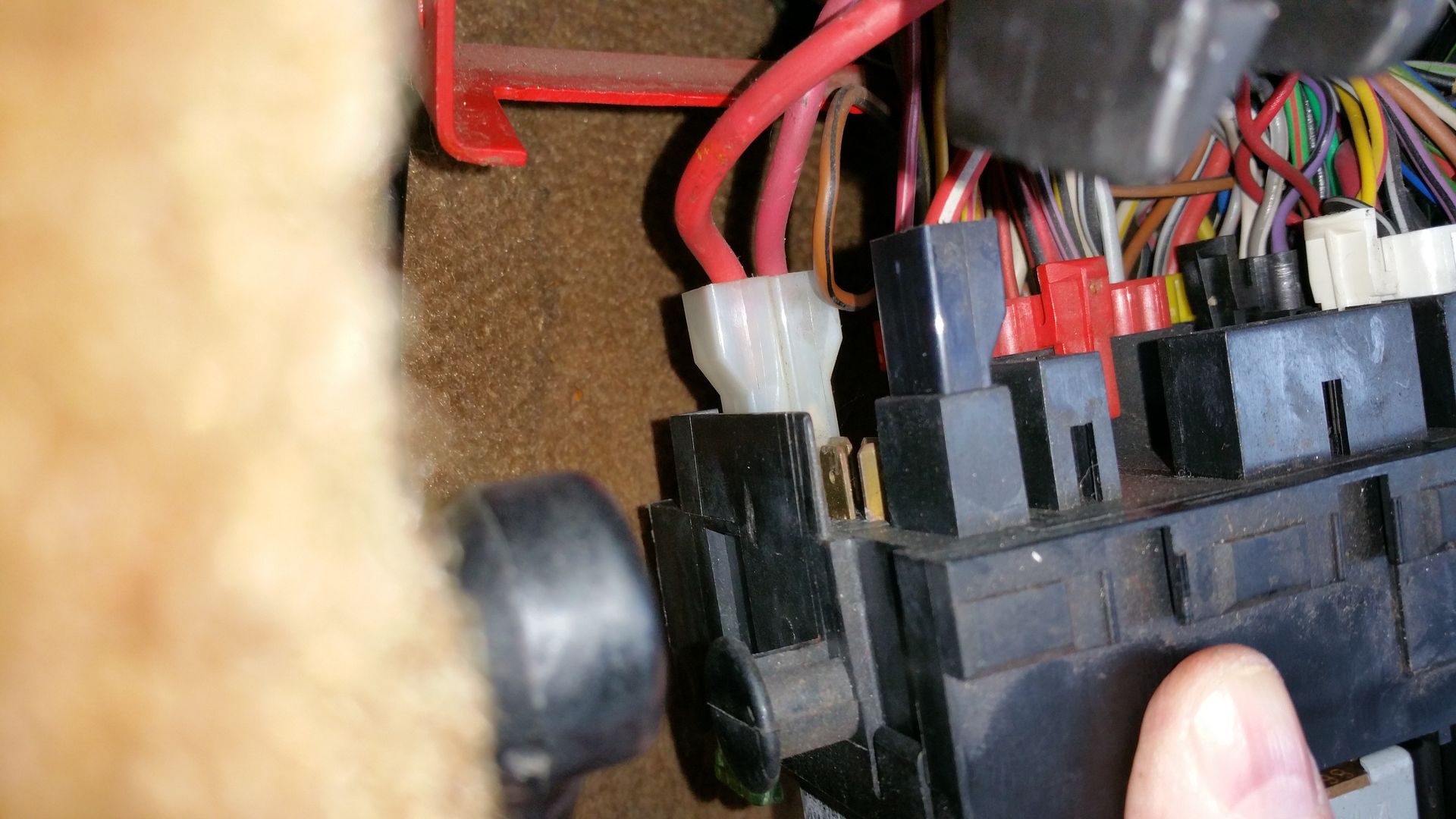

After some help if possible please guys.
I'm trying to find a switched live for my head unit, I've had a search and found that the best place was from the back of the fusebox where there are connectors sticking out (I believe they are labelled 'P' but can't get right behind to have a look)
The connectors on the left of both pictures below
I've tried all of these and they are all live with the ignition off?
Any ideas please?

i thought the switched lives were on the opposite side in a similar location. there is a cluster there. they will have black / yellow wires if memory serves correctly.
what type of fuse do you have blade or bullet?

Cheers for the reply dude.
Ah, didn't realise that. Blade fuses.
But, I had a cup of tea, had a think and decided to go off the heater switch live, fingers crossed.

What Steve said - the opposite side to that in your picture will be a bunch of spade connectors. Look for a solid black wire - that will be a switched +ve as will be the the (hopefully free) connector next to it.

mr.brown wrote:What Steve said - the opposite side to that in your picture will be a bunch of spade connectors. .
There is a block of 8, plus 2 more slightly separated - they are labeled 'G'

Brilliant, thanks for the help guys, hopefully it should be ok running off the heater live but it's always handy to know.
