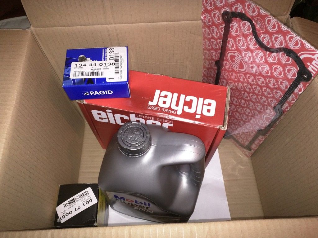

Always a nice feeling to get back from work to see a box full of new car parts.
Nothing overly exciting, but very necessary. They'll be fitted over the weekend provided nothing goes wrong.
Last weekend we had the rear wheels off and found a leaky wheel cylinder. No point putting the new shoes on just yet. So the plan for this weekend is to change the cylinder, fit new shoes, fit new discs on the front, new rocker cover, oil and filter change, hoover and clean the interior, fix the light in the speedo and put the spaces back on that we forgot to put back last weekend and hopefully put a stop to the horrible noises that you get when you have the wrong offset wheels on your car. aaand breath.

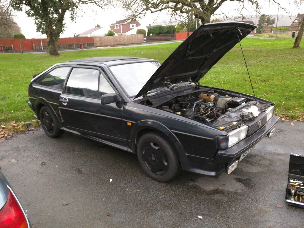

382 bulb is white, looking at the picture above the car is fitted with aftermarket indicators so will need coloured bulbs. Can you get the 382 bulb in yellow?

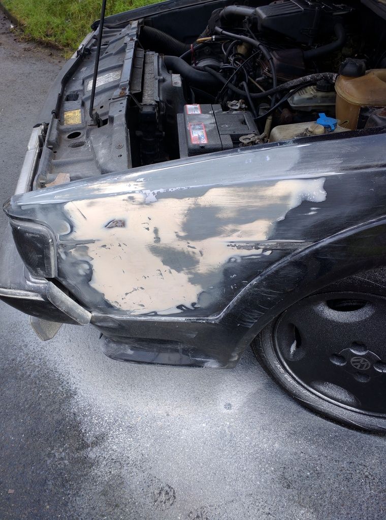

Thanks guys. The indicators arrived a week ago, haven't seen them yet as I haven't been home. Haven't had chance to get any work done, driving to work in the pitch black black and pouring rain, and repeating the process on the way back. Got a chance today on my day off to sort the wing out that my dad "repaired" last year.
"It's sorted son, just needs blowing over"
Obviously I won't be working in a body shop anytime soon, but not bad for a days work. It's getting vinyal wrapped to make it a bit more interesting.

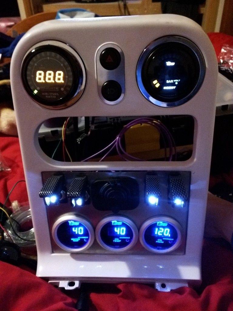

Definitely forgot how much work it is owning a dub. On the plus side the rainy nights gave me time to put this together for my mx5
