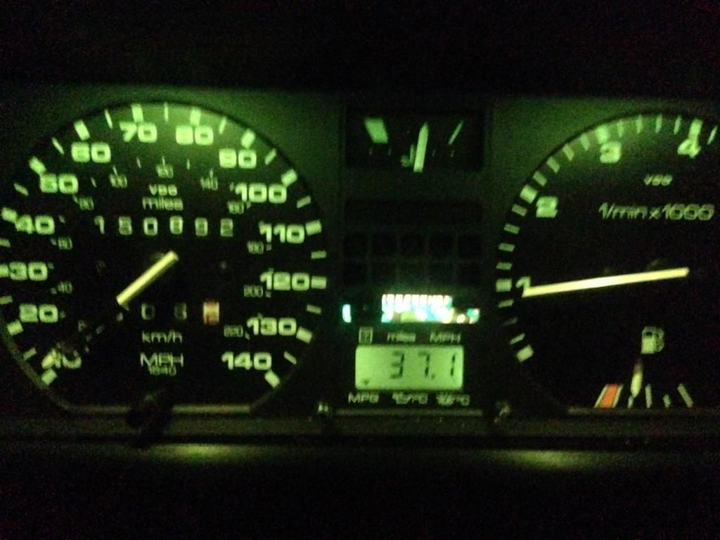

Hi guys having a issue with my speedo, basically I'm going a lot slower then what my speedo reads. It's anywhere between 10-20 mph out... I have found out by having altercations with tailgating drivers on more then one occasion now. Such as being told I'm doing 40 in a 60.
Only thing I've done since I have had it is put some 15" BBS rd wheels on 185/50/15 tyres.
Now I think bigger wheels will affect the mph but surely not by that much?
Time for new clocks?

if i've worked it out right, that tyre size should have you going 2mph slower than indicated (bearing in mind they almost always over-read a bit anyway.
i'd be surprised if you were doing 40 but thought you were doing 60. there is a big difference in the feel of the 2 speeds. i'd compare it to a splatnav or smartphone speedo app and see what the actual difference is

Does it look like someone has messed about with the instruments, eg coloured dials?
They may of took the needle of the speedo and not put it back on right.

Cheers guys, well the miles don't actually turn over at all just stuck on 150k so possible that someone's previously tried to fix this and moved it all out of sync.
Probably time for some new clocks, although seem to be few and far between other then the ebay ones for £150 unless that's the going rate for them?
If I was to strip the clocks myself is there a set place for the needle to sit, and does the spindle bit it sits on need any amount of tension first, I.e do I need to remove the needle then turn the bit the needle goes on or just remove the needle and set it back a bit?

Google VW odometer fix.MattRocco wrote:Cheers guys, well the miles don't actually turn over at all just stuck on 150k so possible that someone's previously tried to fix this and moved it all out of sync.
Put up a thread in parts wanted. The e-bay prices are inflated.MattRocco wrote:Probably time for some new clocks, although seem to be few and far between other then the ebay ones for £150 unless that's the going rate for them?
How to reset the needle but if the odometer is bust it's only worth doing so that you have the right speed until you can get another speedo.MattRocco wrote:If I was to strip the clocks myself is there a set place for the needle to sit, and does the spindle bit it sits on need any amount of tension first, I.e do I need to remove the needle then turn the bit the needle goes on or just remove the needle and set it back a bit?

If the miles are not turning over there is one of the cogs slipping, a common problem and a straight forward fix but can be fiddly.
It seems from the post above there is a mark on the speedo to set the needle so check it's at the right place.
I had to adjust mine on the Mk1 after mine stopped adding miles but the speedo worked.
viewtopic.php?f=16&t=15877
viewtopic.php?f=10&t=17598
The cogs that slip could be the white one here, which is the easy one to fix I used a little super glue to hold it on
Or it could be the harder one to fix like mine the metal (your's might be plastic on a Mk2) as you have to remove the metal bar which hold all the numbered cogs on do the very carefully and make a note of the mileage as I pushed to hard and all the numbered cogs fell on the floor so had to reline all the cogs and fixings to get the mileage right.

I took car out today with a GPS app on my phone and the car appears to be 10mph under what the speedo reads. I stripped it down (well tried) moved the needle back to where it says on the post above, unfortunately I'm not as delicate as I thought as I broke the needle (taped it back together) tried to fix the mileage issue but once I got to it they all span freely and when turning it the mileage goes up, so glued the bite it said. Built it all back up and tested. I have somehow lost a back cover so you can see the board and still according to my gps app I'm 5mph out and mileage stopped again after moving up 2 miles... I am disspointed in myself but hey ho shit happens! New clocks time I think :(

Sorry to hear it did not go well but 5mph sounds about right, my car is about 5mph out on the speedo and has always been like it, even with my wifes honda civic with an electronic speedo drive it's 4-5 mph out. I guess it's so you don't get a speeding ticket
The tape holding the needle may not help as it's adding extra weight to it.
Have you tried resetting the mileage trip to see if that help? I could do that with mine and it would work as far as 0.9 mile or 1.9 miles etc then stop counting or if I was luckly 9.9 miles,in the end it was the harder to get to cog slipping.

5mph isn't too bad so can live with it! No haven't tried that but will give it a go on the way to work today
