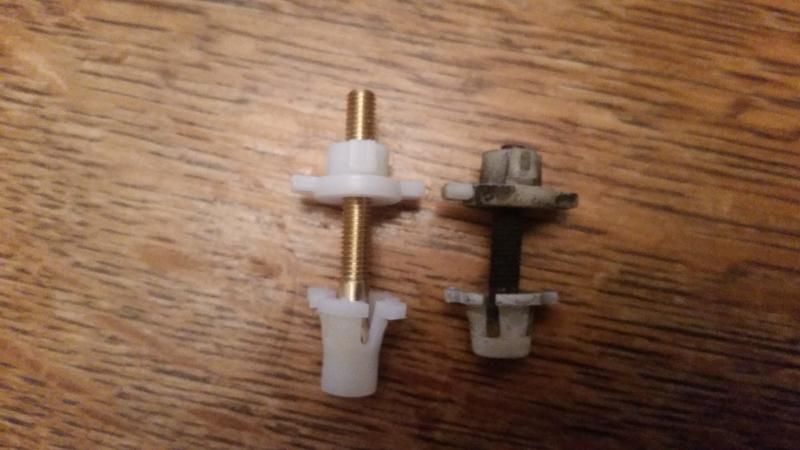

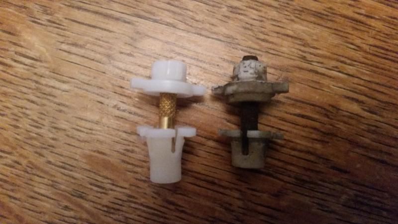

I got a set of mk2 golf/ t2 adjusters from eBay. They are exactly the same as Rocco ones apart from the plastic bit at the frame end which I just swapped over and used my originals. The non adjustable (without thread) item can't be used because u can't swap over the frame end, I did swap over and use the new light end. I can post some close up pics of it in morning if that will help anyone?

These are my Frankenstein adjusters.

Interesting, these are the parts listed for Golf Mk2, two of the part numbers are the same as the 'rocco (barring the leading three digits which identify the model), seems to intimate they're all interchangeable.

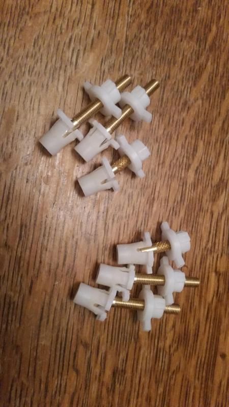

Just in case this helps anybody else out.
I needed to replace the joints/adjusters on my headlights and find new ones to fit new inner lights to my rocco (it's single headlight at the minute). The ones for the main headlights (533941133 and 533941141) I got from VW Heritage , not cheap but at least they were available.
I couldn't find any for the small headlight units (533941133A and 533941141A) but I think I've found something pretty close, Mk2 Golf ones. The first set I found were £17 for three, managed to find them for £6 a set of three on eBay.
I haven't tried them yet as my car is still being welded but they look very close, right lengths, the plastic bucket on one style is slightly longer but it shouldn't make any difference to them fitting and working.
