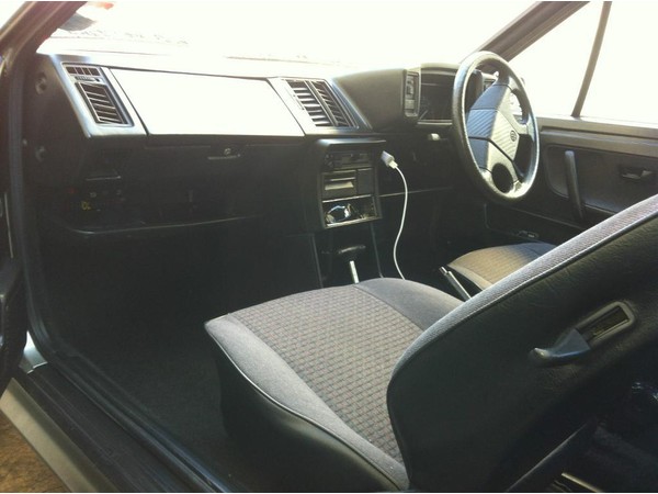

Right been to see the car, overall its in very condition, with the following caveats:
One small rust hole in the paint on the pass door and some bubbling in the same door, overall not too bad at all.
Boot lock seal needs replacing
Rocker cover gasket probably needs replacing
Headlight clips broken on the drivers side fog
Headlight on the drivers side has suffered a stone chip
Accelorator pedal is very high and quite hard (harder than the break pedal)
Takes a little turning over to kick to life but is fine after that and idles around 850
Front pads will need replacing soon
Exhaust downpipe is original and may have a very small blow
Stereo not working? Possible wiring?
Felt like the two main vents wernt open for some reason?
Indicators have a bit of dirt in the bottom of them
Drivers side drive shaft gaiter may need replacing
New Mot (failed first time on bearing) looks like the last MOT was in 2010.
Long tax
All of these things do not worry me too much but what does is he said he only has the V5 slip as he's sent away for ownership. When I asked where the car was registered he was a bit vague as he has a place he resides in and a house he's not staying at..
He has 2 sets of keys but if I were to buy it would there be any trouble only having the V5 slip? Presumably its better to wait until the V5 arrives..

bluestreak56 wrote: Accelorator pedal is very high and quite hard (harder than the break pedal)
The Scirocco auto's I have driven all had a harder accelerator pedal. This is due to the addition of the kick down cable and different routing. Usually sorted with a good cleaning/lubrication of the mechanical linkages and pivots but it definitely isn't the regular set up of the manual.
Exhaust front pipe normally fail on the weld between the two pipes inside the front joint. You can hear the blow but usually can't see it.
Yes, I think up to 84/85 cars (until they'd used up all the old stock at the factory) had the yellow full-beam indicator light. You'd therefore want to question the mileage as this car may have had the clocks replaced at some point. Did all early mk2s have the fuel economy gauge, or was that only better-specced models? Usually I'd expect that, along with the water temp and fuel gauges inside the rev-counter, when you have a yellow full-beam light (I think).
the edmundator wrote:Yes, I think up to 84/85 cars (until they'd used up all the old stock at the factory) had the yellow full-beam indicator light. You'd therefore want to question the mileage as this car may have had the clocks replaced at some point. Did all early mk2s have the fuel economy gauge, or was that only better-specced models? Usually I'd expect that, along with the water temp and fuel gauges inside the rev-counter, when you have a yellow full-beam light (I think).
Yes, the early cars had the fuel economy gauge as well. My Storm is an 84, it has the blue main beam warning light and the economy gauge and yes the fuel and water temperature gauges are in the rev counter.
