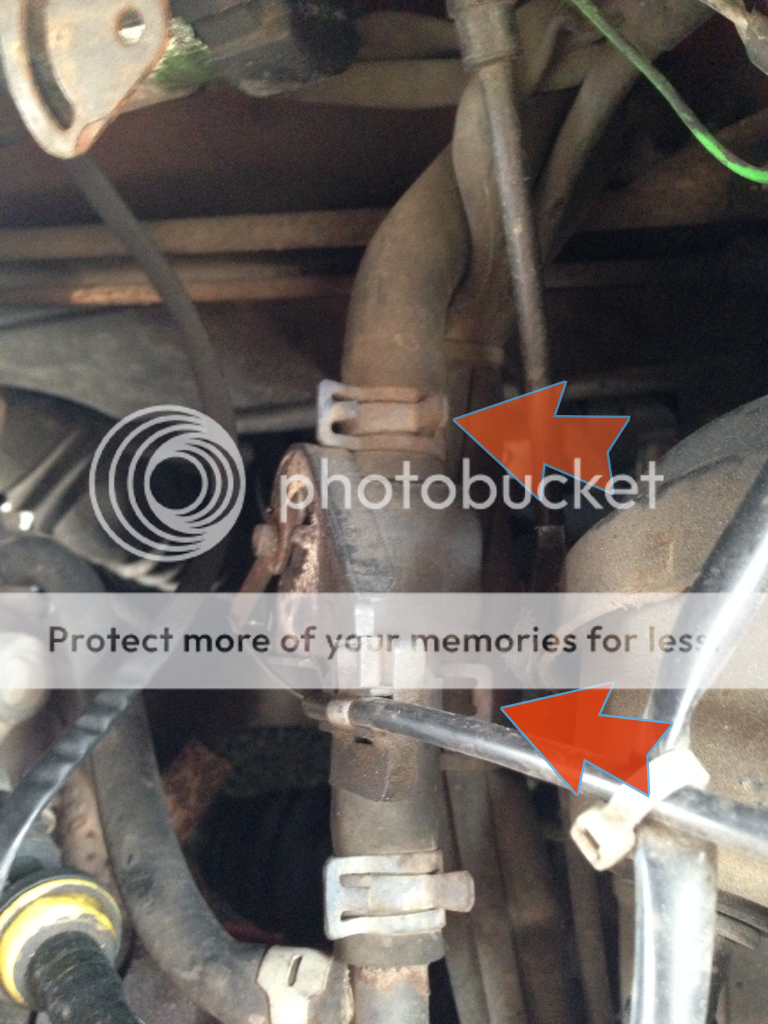

Re: Heater on full
Iv got the same issue on mine, iv got a new valve ready to go on, am I right in assuming it's just the following two clips to undo?
And when I pull the pipes off, will I be expecting fountains of coolant or just a little dribble to come out?

Re: Heater on full
Yes to the pipe clips and no to the fountains, so long as you don't do it after a run or when hot, and leave the cap on the reservoir whilst you do it to prevent air getting in which minimises the amount of water coming out at the heater valve pipes.

Re: Heater on full
You will also need to remove the clip which holds the cable to the valve as the new one does not come with one and make sure you put the cable back on in the right place, you will need to check this by sliding the heater control from hot to cold and make sure valve opens and closes.
