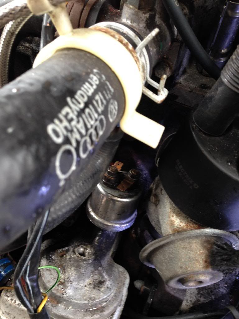

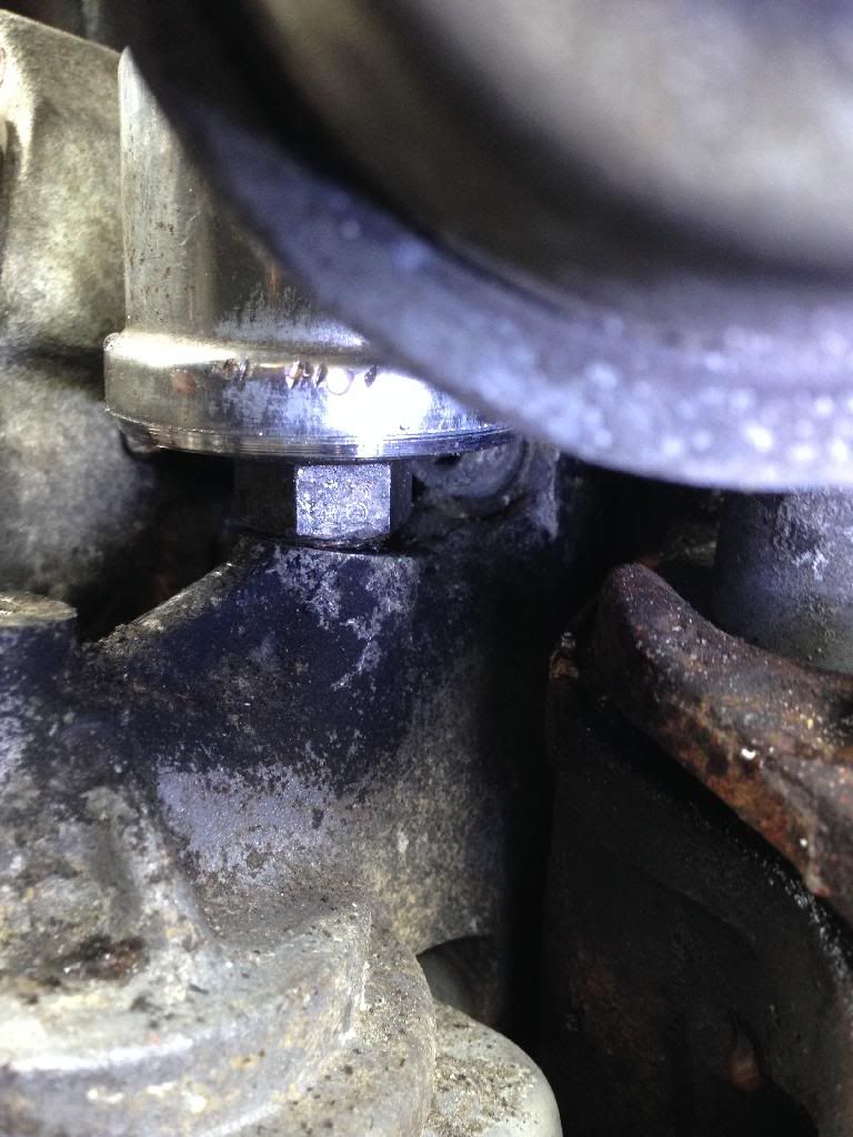

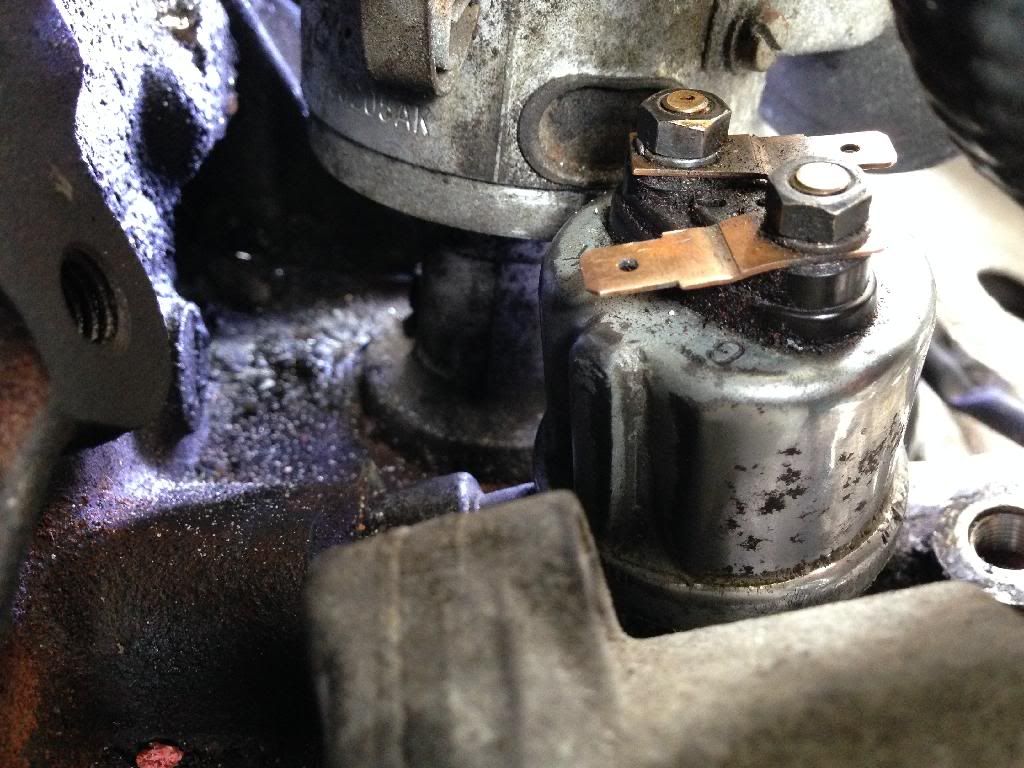

OK this is now driving me insane, when to put the pressure sender in today and it doesn't seem to fit... it hits something at the back. Any ideas?

Jack, you are correct, it doesn't fit there. On the right side of the cylinder head as you look at it from the front is the low oil pressure sensor for the oil light on the dash. It will have a blue and black cable going to it and possibly a black rubber boot over the sensor. Take the sensor out and replace it with your 2 pole oil pressure sender. Connect the blue and black cable to the WK pole and run a new cable through the bulkhead and connect to the G pole on the sender and the G conn on the oil pressure gauge. This will give a reading on the gauge and it will also allow the oil lamp on the dash to work when you start up and if the oil pressure gets too low. If you want the lights to work on the gauges connect to the wires running to the fag lighter lamp in the ash tray. Hope this helps.

Ah ok thanks mate, where have I put it then? It was on the filter housing just behind the temp sensor

It could go there if the sender was smaller but as you found out the one you have doesn't fit. Make sure you blank that hole after you move it and before starting the engine as you will empty the sump in seconds!!!

Haha yeah I did (well I put the sensor back as there was one in both) thanks again mate :-) all works

The sender on the filter housing is the high oil pressure switch.
