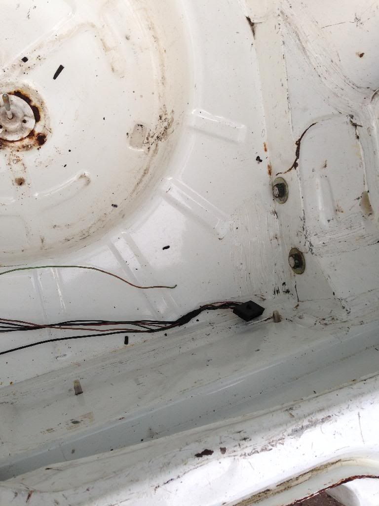

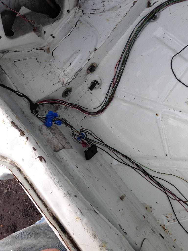

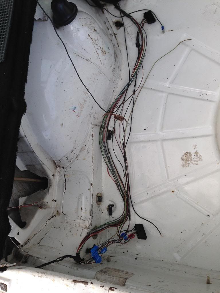

Hey guys.
As some of your know I've finally got round the starting the Rocco and it appears that's the wiring has seen a lot better day, if possible could somebody take some pictures for me? Or shed some light on how these would be wired.
The rear lighting loom as pictured
The boot light switch
Rear of the fuse box
Under the steering wheel
Yeah I know there's a lot there, but I don't know what's right and what's wrong anymore lol.
Thanks
Some images of what I found
Jack
South East
VW Scirocco Scala MK2 1.8 Inj
Jaguar F-Type
Nate
Posts: 4045
Joined: Thu Apr 02, 2009 10:37 pm
fill in the right answer: 10
Location: Cirencester / Swindon
Re: Mk2 wiring pictures/help please (scala 92)
Post by Nate »
Those blue things are known as scotchloks, and are the work of Satan. If that's the rear lights, i'm guessing it has (or had) a towbar fitted. They should be removed and replaced with a decent joint. Solder and heatshrink for preference.
