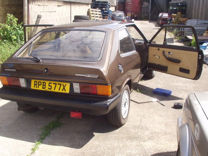

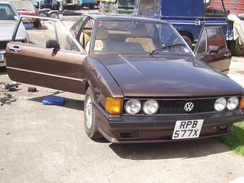

So picked up this mk1 Storm on the 21st June 2009 with the Lilac Trailer supplied by Knights Light HaulageTM
Got back all safe and sound to the Workshop for recommissioning
The car has been stored in a dry garage certainly for the past few years and by what i can tell from the history, most of its life, so it is in very good condition. It has been restored at somepoint over the years, treated to a new sill, new wings and a respray. More recently fitted are new brake callipers and hardlines. the interior suffers no rips or tears. The cosmetics just need a good clean up.
the car was taken off the road due to a running problem, thought to be electrical and further investigation seems to bear this out. So it was time to recommission and sort out the gremlins:

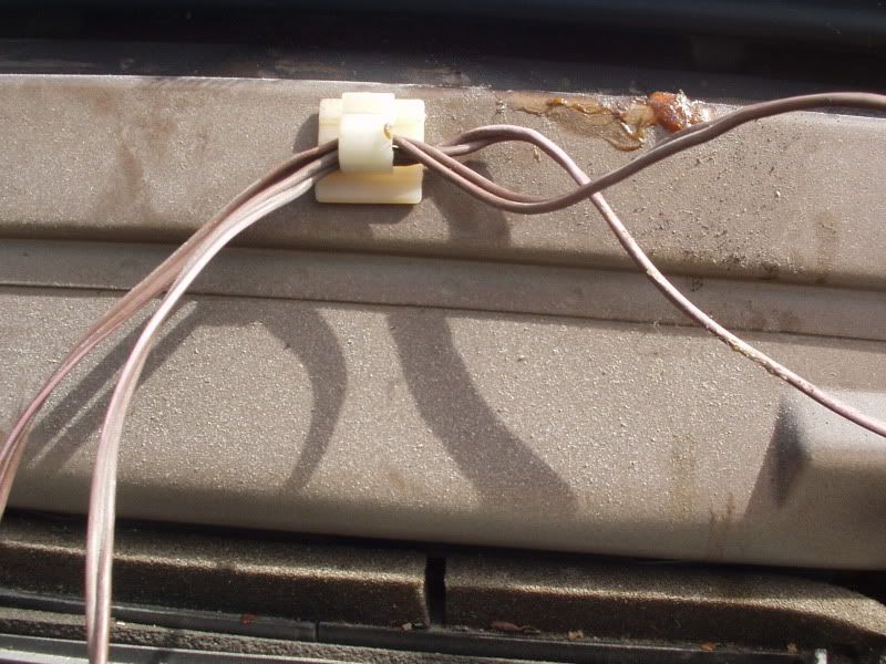

and hey kids, remember to gain those extra concourse points you need to have this widget in place to hold your loudspeaker wire in place ;)
