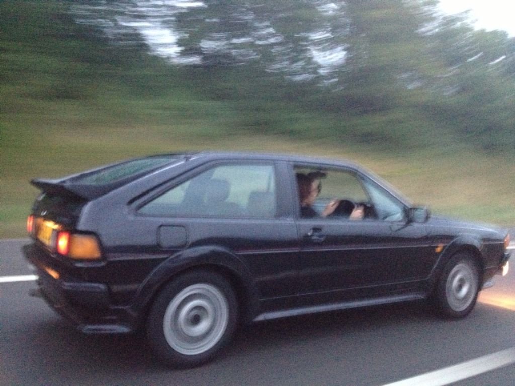

just picked up my first rocco tonight to add to the 16vmk3 I have :) got a bargain and it looks so wicked! it's got a scirocco register sticker on it so maybe at some point it belonged to one of you?
here's the only pic I have
such a cool car. handling is so different to my heavy mk3, really fun. let the project commence!

Looks nice, guessing a Scala?
More pics of it not moving!

Welcome.
Nice shot.

yep she's a scala..
