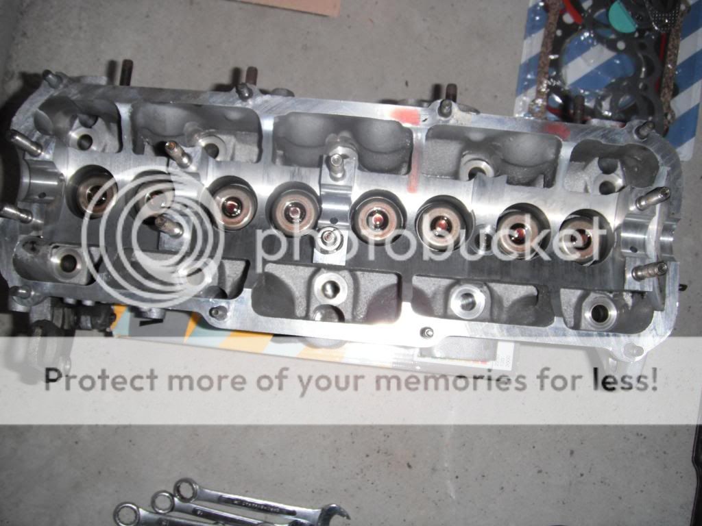

Next I decided to give the had some attention which involved new tappets, new valve guides, oil stem seals, and the valves and seats getting re ground for a good fit. I also sent the head off for a light skim just to be safe and maybe raise compression just a teeny weeny bit. new cam belt and tensioner went on too. Got a full gasket kit and gave everything a good old clean. there was some nasty gunk in the inlet manifold! and I fitted a new rubber carb mount while I was at it.
after giving everything else in there a good once over and clean or recon, the final touch was a freashly painted rocker cover and a crankcase breather filter to replace the breather hose, the heat exchange section of the intake was also removed to make things simpler.
