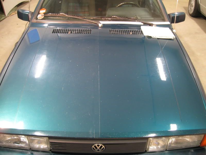

Paint looks good after washing
But reality is shocking. Rocco has had it's share from acid rain, stones etc...50/50 after heavy polishing with rotary, woolpad and Megs 105

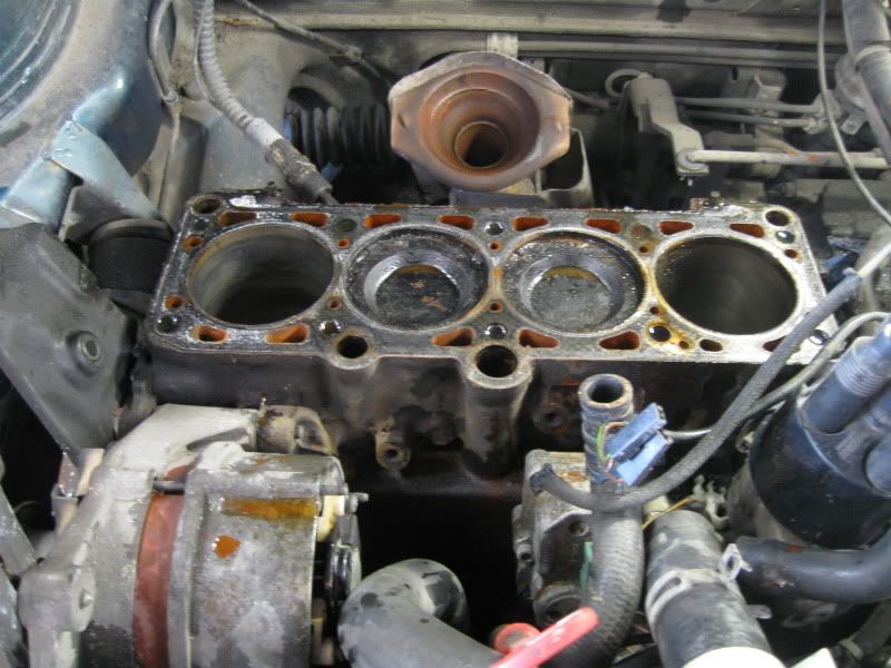

Rocco was booked for painting 11.6 but then nice white cloud started to follow the rocco
What do we have here...
Head gasked had failed and coolant leaked into 1. cylinder. Funny thing is that Rocco had total top end reneval 43kmiles ago. New seals from Elring, new water pump + other goodies only costs under 150€ so no disaster
Machinery shop took 69€ for checking the head. I dropped it yesterday 11am and got it back 1pm so fast job because we have holiday today
