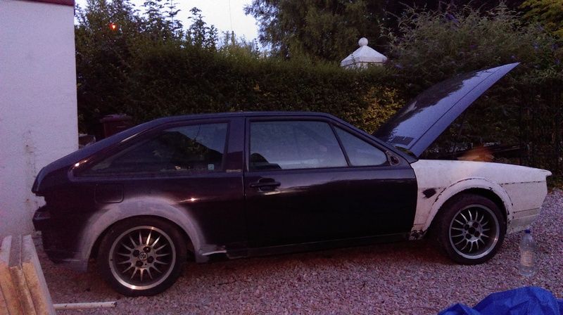

Re: Blast from the past - Marmite
The exhaust pipe fitted like a dream so very happy. Then added some fuel and after a bit of fiddling, she lives! Whoop! Sounds tappetty as hell though! It's a dx head so hydraulic. I guess I'll be replacing those! Could it just be the high lift cam? Still tappetty even after warmed up. I am over the moon to move her under her own power after so long ! Brakes need bleeding again though.
So no good photos, just took a quick snap before it got dark
