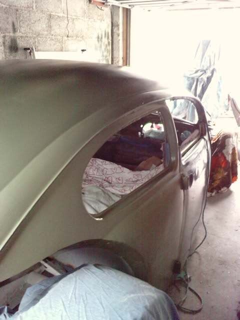

ah poo. just wrote a post and deleted it by accident! heres some pics of cars i've had since i was last one here. and some of the beetle which is...er...ongoing :)
beetle
before
after
the audi I owned for 2 weeks before the ex took it :(
landy - bloody brilliant
resprayed ready to sell...
the boat
westy - currently on ebay
my daily - this is where i'm getting the 200bhp 1.8T for the rocco from. sorry audi.
