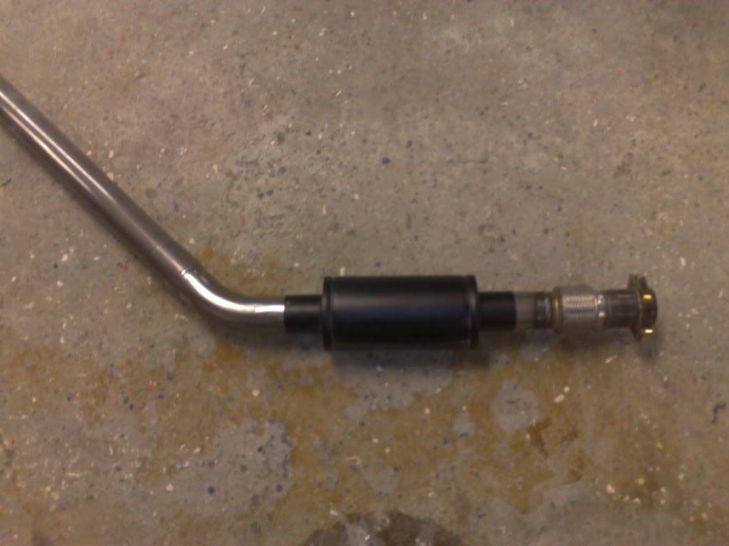

My exhaust is 2.5" all the way...
I welded a short section of tube to the seperate flange you get in the kit that bolts up to the flange on the manifold.
Then got a flexi pipe to take the strains aand hopefully prevent the manifold cracking and attached to the short tube.
Sorted another length of tube and then put on the centre silencer (which does not do anything to make it silent lol)
Then put in a bend and a side exit.
I made the exhaust myself and got the bits needed from merlin motorsport who I thought had very reasonable prices
(The pic below was a mock up and not the final design)
insanecreations.net
