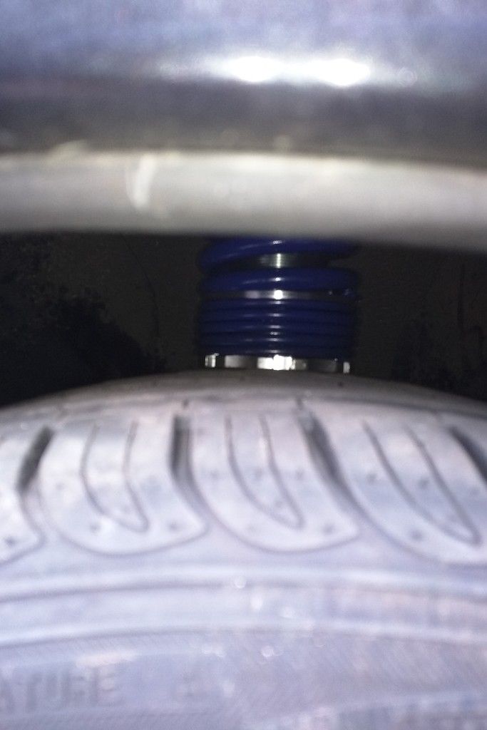

Needed new shocks for the MOT, now running a set of cheap and cheerful vmaxx coilovers.
Fronts need adjustment.
