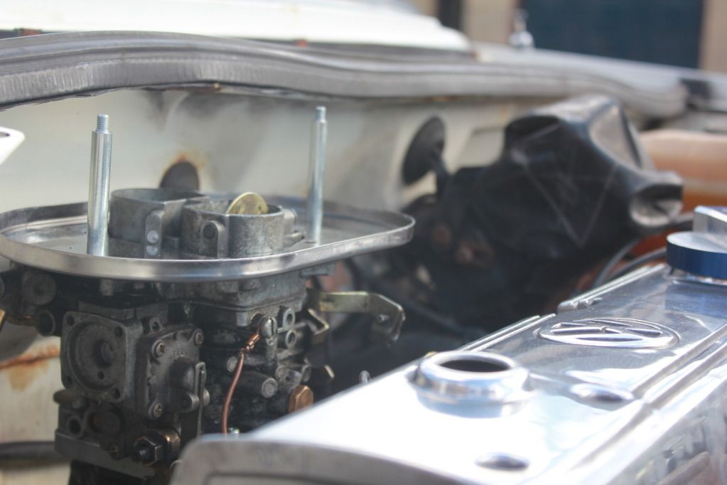

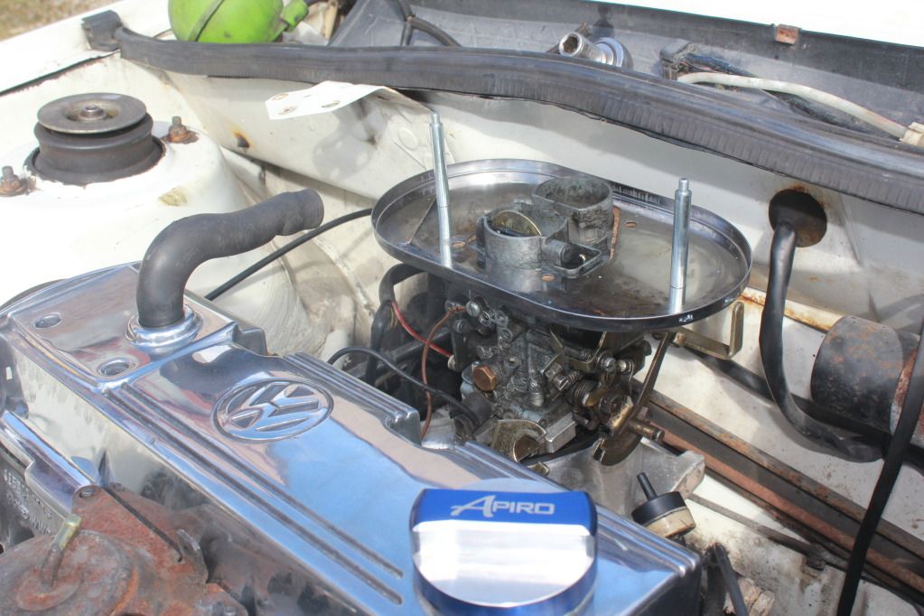

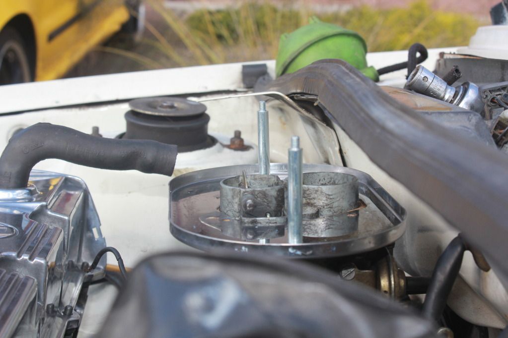

First problem is the bloody K&N Filter I bought, It won't fit, few pictures below to show what's going on.
Is there anyway to get past this, or am I looking at buying another smaller filter?

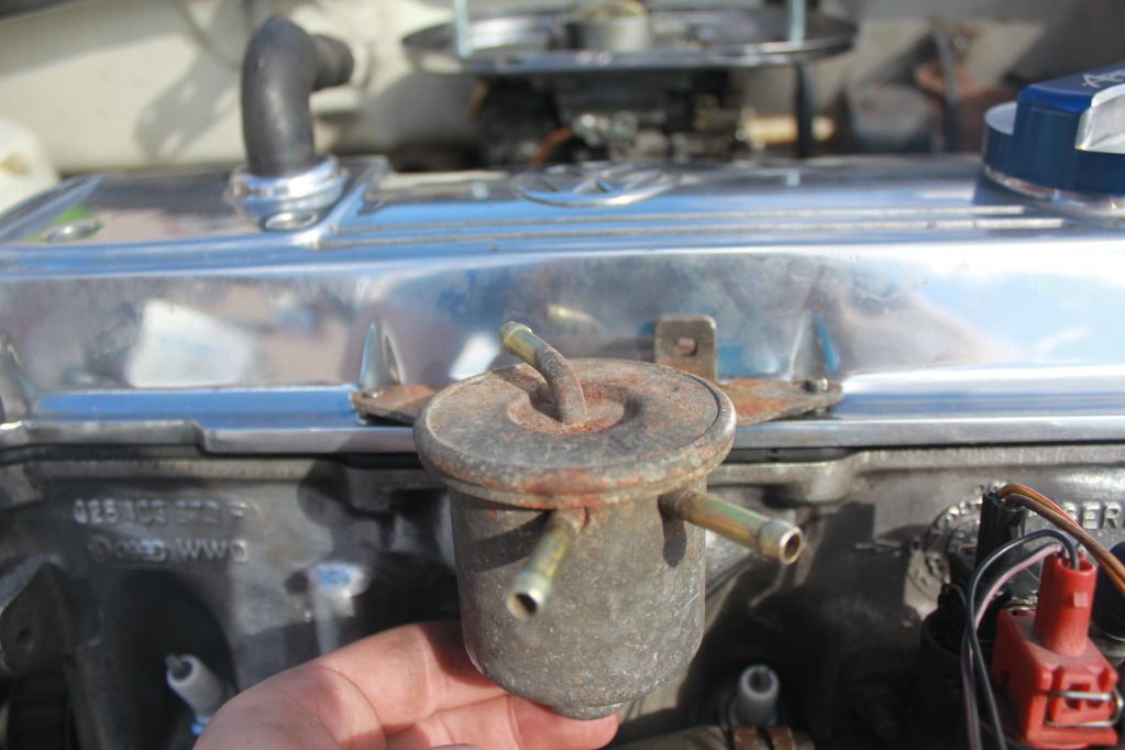

Next problem is I got a mk3 golf gti rocker cover, all nicely polished etc, but it's stopping the 'thing' that the fuel lines go into from sitting snug and it won't bolt down properly, any ideas what to do, picture below.

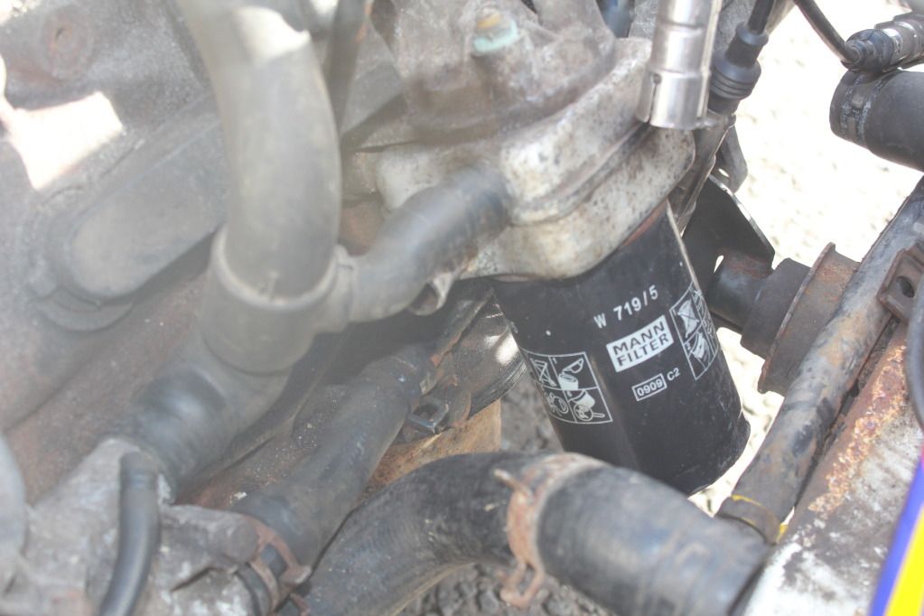

Last but not least, this block has an oil cooler on it, which my previous one did not have, I've got a pipe for what appears to be the inlet, but where does the outlet pipe go to?
Not a very good picture, but hopefully you will get the idea.

With my oil cooler there is a hose coming up from the rubber water hose which goes from the bottom oulet of the water pump to the metal water pipe (you can see this hose with out the extra pipe on in your bottom photo, just above the bottom radiator hose) so you might need to get a different water hose. I think the part number is 068121058C but don't quote me on that code as its for a Mk1 Golf DX engine!

Problem 1 - The 2l block is physically taller, so your carb is closer to the bonnet. Smaller filter time. Or twin carbs if you don't like money.
Problem 2 - You can get longer head studs. Have you changed the gasket to a MK3 Golf one already? If not do so, the kit I bought came with crazy long studs that would solve your problem. Of course, if your running a single carb with a mechanical/low pressure pump, you don't actually need that reservoir.

Problem 4 - Personally, I would do away with the factory oil cooler and get a Mocal style one. Much more reliable. What I did on mine, not cheap but far more safe and looks better too.

Eventually got the Air filter to fit! Just took a bit of fiddling with.
Yup I used the longer head studs, didn't think of that, thanks!

And I sourced the right pipe for the oil cooler, so that's sorted now too!
