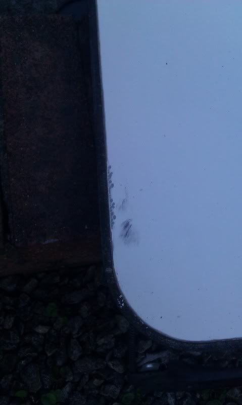

Ok so after a great noght of cleaning and t-cutting and washing ready for Alltypes, i got in to the car to back it up when a load of water drops onto me shoulder!!!!! i get out to find that the seal around the tilt and slide sunroof had cracked and sunk!!!! si i assume that too much waster had got in and overflowed from the inside drain gutter.

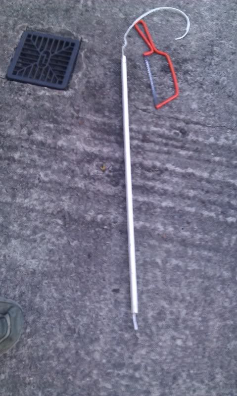

Nate, you were right, had a blocked drain hole, and the git was the rear drivers side, so i had to remover the sunroof, to be honest its really easy, just should have read the instructions more as i tried to get it out with the roof rolled all the way back and did this-
and after half an hour or so of trying to get something between the outer and inner roof came up with this, bit of plasic piping (been in the shed for years with a "that will come in useful" mark on it, nearly went to the tip last weekend) and some electical wire. Just fed the pipe to the drain and pushed the wire through to clear the blockage-
