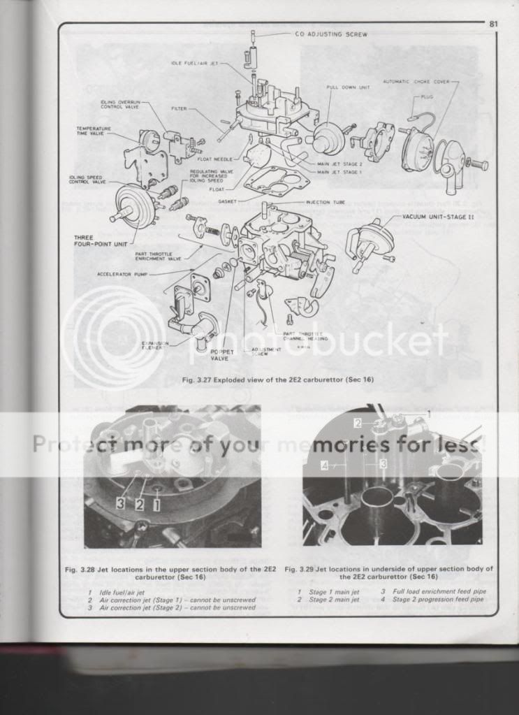

Re: This thing. Is it important?
Re your carb adjustment screws if it is a 2E2 this may help you.
