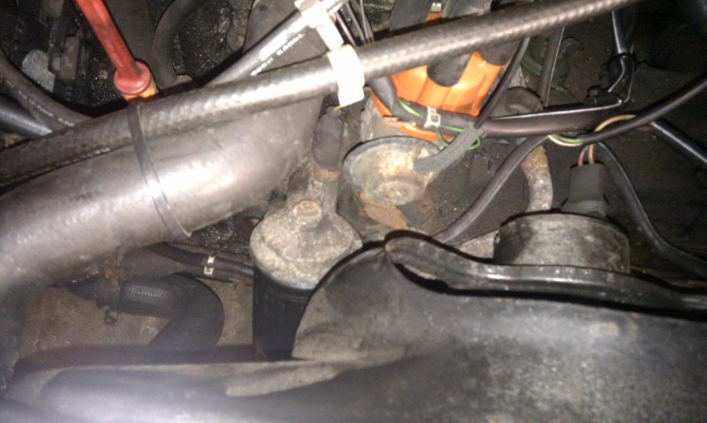

My GT has this Oil filter set up and that green wire with spade in place..

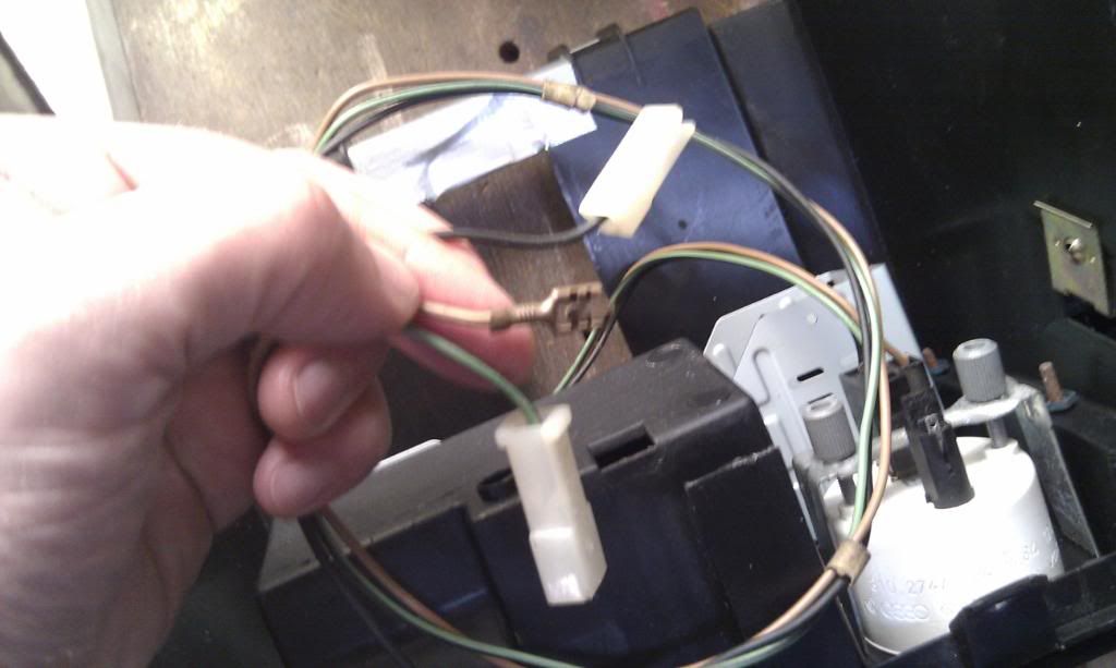

These are the wires on the gauge..
So how does this wire in?Clearly I need power for the bulb in the gauge (maybe take from the ash tray light) but do I have to buy these items?..

Hi Mac, Yes you need a sensor but you need to make sure you get the correct one for the range of the gauge. The sensors you can get from the dealer for less than the one on ebay so investigate them first. The range is etched on one of the sensor flats something like 60 - 180C and should correspond with the range numbers on the gauge. The sensor goes in the hole you can see on the second ebay item (filter housing) which you don't need by the way, just remove the plug in the top of your filter housing with an allen key and fit the sensor with a copper or soft aluminium washer to seal it, don't overtighten it though. The power for the lamp can be taken from the power to the ash tray lamp which only comes on when the lights are on and any earth. The 3 wires for the gauge are switched live which goes to the +ve, this can be from the fan switch if your black one is not live already, an earth (brown) which goes to the -ve and the green/black one which goes straight from the sensor to the "G" on the back of the gauge. Hope this helps.

I was beginning to think that there might be a removable plug that I wasn't seeing under the surface corrosion. I'll try the dealer for the sensor that as you say should correspond with the gauge. The light from the ash tray makes sense. Just need to figure earth and live as you describe.
So that green black wire and spade isn't relevant unless I find the end of it near the fuse box and replace it with the one on the gauge? that right?
Any further explanation would be appreciated Mr Funk :good:

Earth wires are always Brown. The Green/Black wire by the filter runs to a spade just under the fusebox on later Mk2's, feel up behind bottom right side to find it, however you are showing a green wire in your photo so test this one back to the spade at the filter for continuity and you may find that this green cable is the same one. If not then find the cable by the fuse panel and extend it to the back of the gauge.
