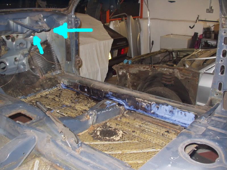

Finally, after I hate to think how long I was able to drop the column …
The damned pesky bracket was finally removed …
And the engine bay is almost clear enough for the blasting to be done …
This has probably been one the most tedious, drawn out and frustrating tasks I’ve undertaken so far on Poppy. However, on the plus side I have gained some useful knowledge and even some new tools along the way so a result in more ways than one!
