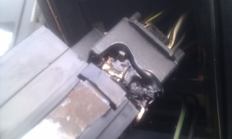

smoke from dash.......

looks like another failed switch. ... seems to be the fashion on here at the moment!
Just flagging up that if you fit an upgraded headlight loom (search ebay or build your own) the (new) switch will be operating at a much lower current, which can only be a good thing in the interests of reliability.... The lights will be better too!

yep, almost certainly the switch.......I have a choice of 7 available..i will need the part number first though.
£12.50 posted to uk...............

cheers guys was the switch lol,
