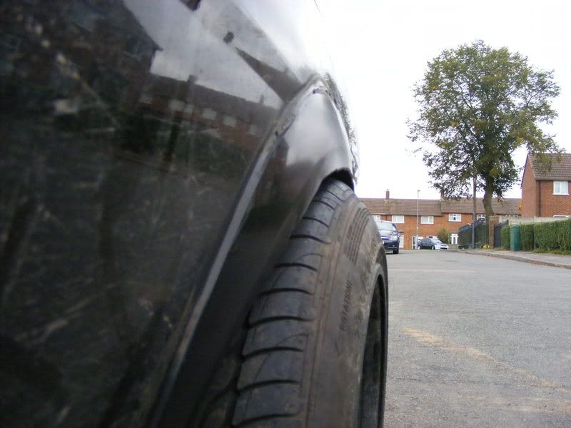

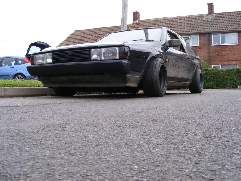

its not about the width its about the offset of the wheels. i had 13x8's on the front and 13x9's on the back with silly low offset. even with the arches pulled about an inch on the back they still stuck out far enough for the old bill to threaton to tow and crush it lol.
the problem is roccos can't get the front low enough to pull off 13's with stretched tires because the bottom of the engine is sitting on the floor before the tires are in the arch, 14's look much better on them.

cheers for the pics
I think i might go for 8x13 now as 10x13 will stick out abit much also are those Wellers ? i was thinking of a set of them

by RoccoGuy » Wed May 20, 2009 9:09 pm
yeah there wellers mate, loved them to bits but would never be able to get them legal on a car without some thing like burg arches.
