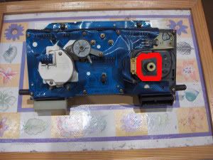

i'm about to put my 'Rocco back on the road (MOT on Sat morning :training: :read: ) but i managed to pull the speedo cable out when i mistook it for the clutch cable :blush: :blush:
how do i get it back on as i'm assuming it's an MOT fail? :dunno:
is the circled hole the bit it goes into
and which way up does the white clip go?
ta in advance
Danny

It's a push fit, you'll feel it click into place.
It's a 360°fit so doesn't matter about the orientation of the clip.

And it will not affect your MOT whether it is connected or not.

Done it! :yup:
will find out tomorrow if it works or not. :dunno:
Much easier than i expected :groove:
