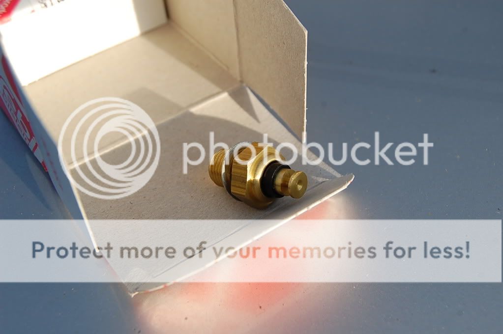

so my rocco decides its overheating randomly when it really isnt.... I was told by a garage that it was the temp sender... i went to a local VW suppliers and they sold me a 'single pin' temp sender.... I havent a haynes yet, or know anything about 'roccos really! how is this changed over? where does it go!!?? lol its a little brass thing.... is it the right one?? lol
seriously havent a clue!! :dunno:
help appreciated!!
oh, its an '84 storm, 1.8 gti engine....
any ideas if its right?? how to change it!!
thanks!!
Ed

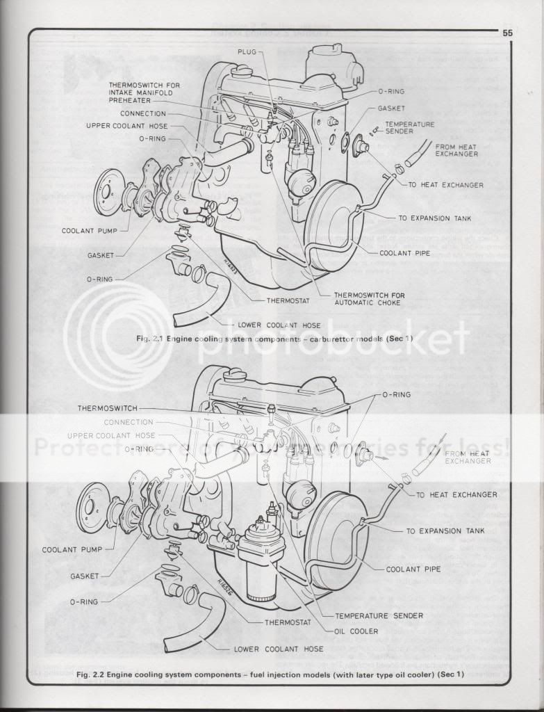

Hope this helps, sometimes a picture is a lot clearer to understand.

In Fig 2.2 in the picture above, the sender may well be in the top of the flange rather than the bottom.

is this the right thing??
