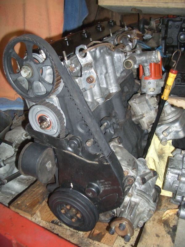

Yes cover just there to protect hands etc, The bolts can get rusted in so you may need to fit a new bolt once you get it off I smeared a little copper grease over my bolt when I put it all back together.
Pictures..
When I fitted my cam belt, you can still access the bolt with the bottom cover fitted but it's best to remove the top cover (as in picture) so you can see what's happening with the bolt and if you are rounding it off.
Pictures..
