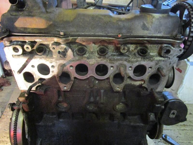

Hi,I have searched but can't find the right answer. Basically the 1.8 carb engine is goosed so I have bought a 1.8 8v gti engine which I'm guessing is from a mark 1 gti as it appears to have kjet and looks otherwise the same as the scirocco engine. Can I effectively swap the 2 manifolds, connect everything else up and run it? It's my Mrs pride and joy and I need it up and running asap so converting to injection is not the way ahead just yet. Any advice or links would be welcome. Apparently there was an FAQ that has been linked to many times but the link is dead.

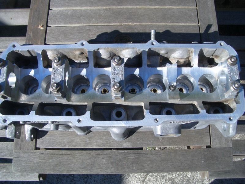

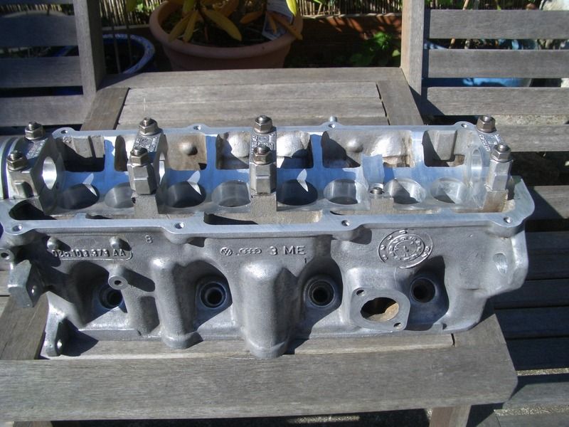

There is no water/coolant pipe on the back of a DX head, there may be a air pipe (to add air to the fuel injectors)
I thought that the Carb heads had a water pipe running around them to the inlet manifold to heat it up?
Picture of a later DX head with air should injectors (pipe between Cyinders 3 and 4) and hydraulic tappets, you can see the 4 holes near the top of the head for the fuel injectors. I'll try and get a better picture for you.

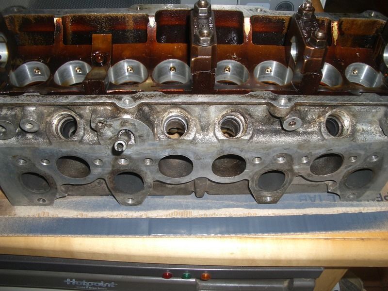

you can see the coolant pipe i refer too in your picture mark1gls between inlet 3 and 4 where the manifold bolts up to, just above the stud sticking out. it looks like a short metal pipe sticking out of the head maybe 2cm long, on the carb version that coolant pipe isn't there its just a flat hole and a special seal goes between the mating face of the carb manifold and the cylinder head.
before the carb manifold can be bolted on im sure this short pipe needs cutting off flush with the head

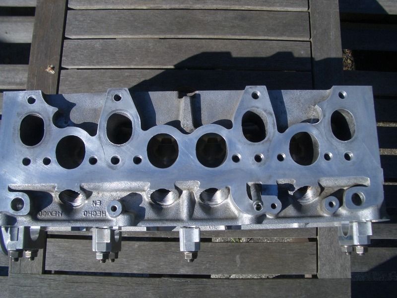

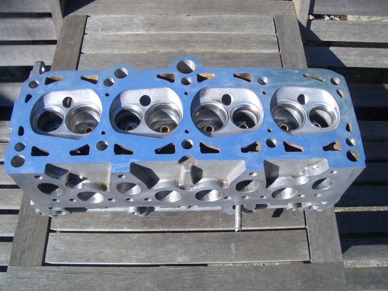

Some better pictures for you, the "coolant pipe mentioned" which is an air shroud you can see in this photo, you don't want water running around it as it runs to the 4 injectors then into the inlet chambers as you can see now I've removed the injector seats.
Some more pictures now I've had the head cleaned.
Picture of the injector seats (and broken bits when I was removing them from the end) which you will need to block up.
If you need any photo's let me know but I'm rebuilding it back up at the moment.
