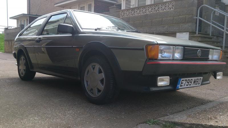

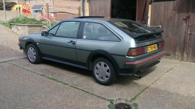

I spent some time over the past few days respraying and fitting the Zandvoort wheels

I like them wheels.

The wheels looked a lot lighter shade of silver before I put the lacquer on then they went quite dark. Theyre ok for now and a massive improvement on the mullered p slots that were on the car but I might spray them again a bit lighter one day. I considered doing them white but thought it might be a bit to chavtastic for an old gtx!
'88 Jade Green GTX
Re: My Green '88 GTX
The wheels look good as they are mate. I think white would look shite and very 'Maxpower', something a 19 year old would do to a Corsa or Saxo!!!
