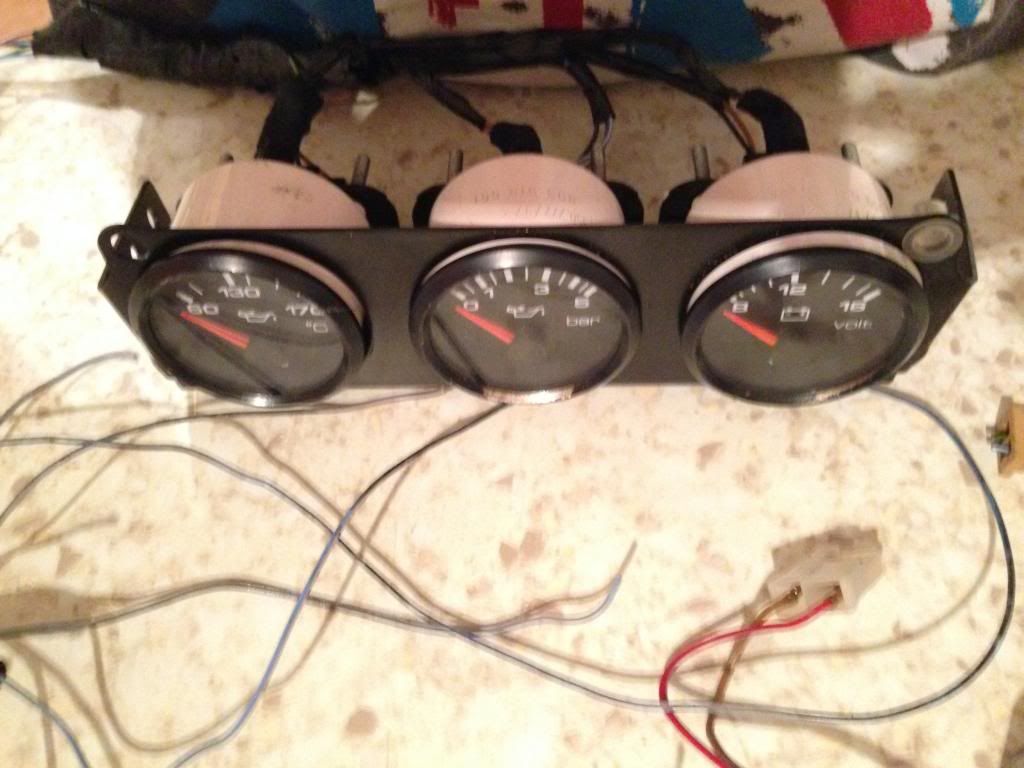

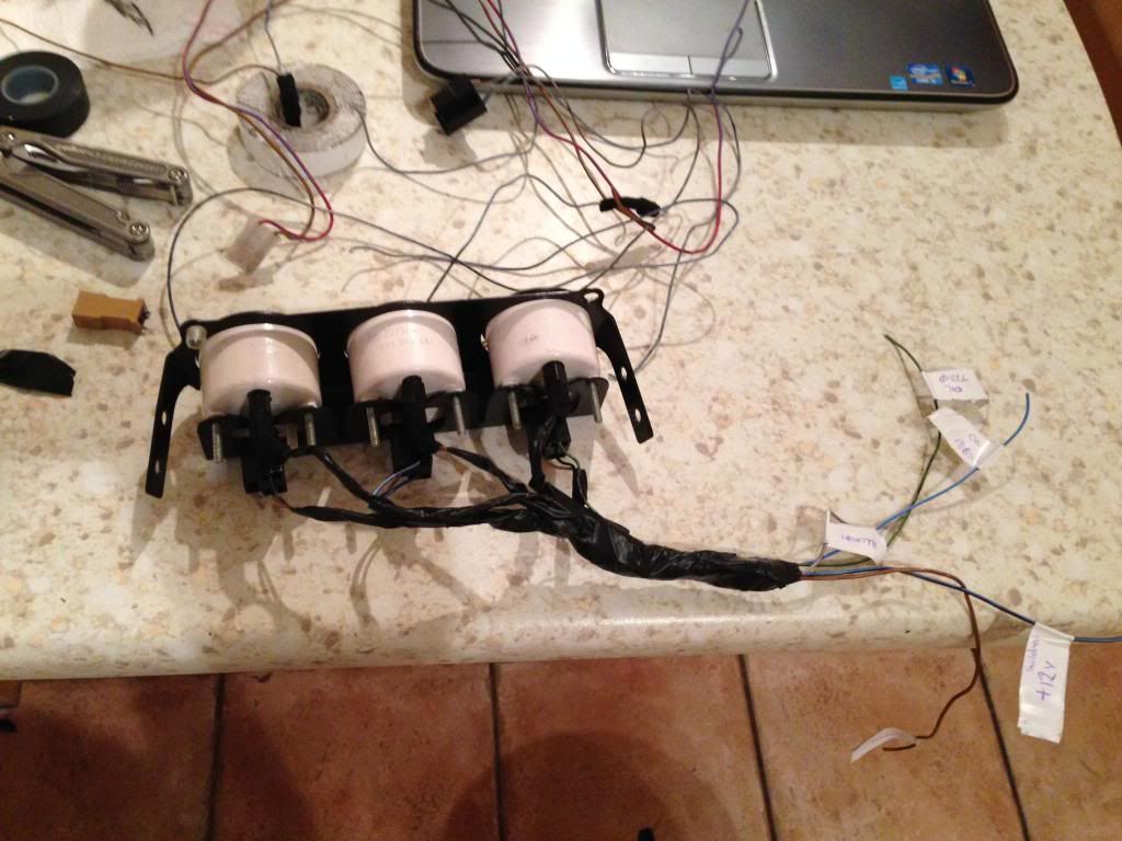

made quite a bit of progress after having today off work :)
found out all the info i needed on the last post (if anyone's stuck just ask). Gauges arrived, remade the loom to include only the cables needed for the rocco and found some decent guide for 1. the standard audi 80 gauge wiring loom (what does what) - http://www.dubforce.net/forums/index.ph ... opic=18269 and i also have a pdf of 3 different ways to get the front glass/screen off vdo gauges. (would upload it but no idea how)
As i said above if anyone needs a hand with it let me know and i shall do my best to answer your questions
