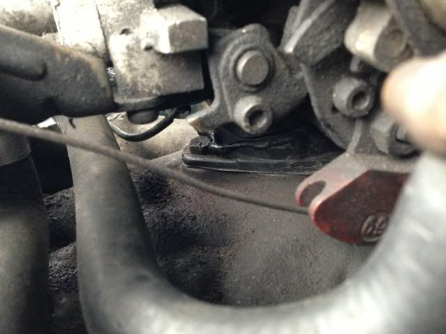

since getting the car back and having a play it seems to have some problems, it fired up pretty much straight away but seemed to run a bit lumpy, probably about 5 min later it cut out. it would start up again alright but then cut out slightly quicker until i would be starting it up then about 30 sec later it would cut out. After having a read though the forums i had a look in the tank and found what does look to be some rust flecks, which im guessing are coming from the filler neck :(. what is the best way to fix this?
The other thing i have found is that the carb seems to be very loose/ wobbly, is this normal? here is a pic of the bottom of the carb with seems to have some sort of sealant on it, bodge? Could this cause the running problems?

get an aerosol of carb cleaner. spray it round the rubber mount with the engine running and listen for the note to change. if it does, carb cleaner is getting sucked in. replace the rubber mount and make sure the front mount is also still solid, job done. if note doesn't change, you're gonna have to look elsewhere.
