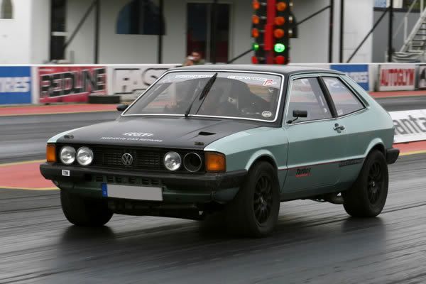

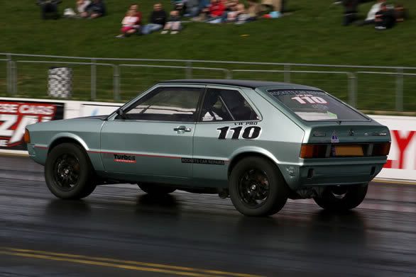

This is my mates motor Paul Jordan - Thought you lads might be interested in seeing this. Its a well known car on the drag racing circuit and will be running many events this year at Santa pod.
650bhp 4WD
o - 60 mph in 2.5 secs
last year ran 10.1 qtr mile - aiming for 9's this year with an extra 100 bhp + many more mods
geared for 220MPH but not used for top end runs
2.1 motor, steel billet crank, arrow rods, cat cams, 1mm oversize supertech valves fitted to ported/flowed big port head, direct port nos ( 150 bhp jets ) garret gt30/40 turbo, 44mm tial external wastegate, fitted to bispoke tubular manifold, six speed tt gear box with diesel final drive, daldex 4 wheel drive, g60 back end, IRS.
New berg cup wide arches, front wings and front skirt being fitted at moment in new colour, 10.5x15 image split rims.
Will be going all out for a 9 second 1/4 during the 2009 season.
Best Achievements: Class wins at gti international 2006/2007/2008, did 0-60 in 2.5 secs in 2008, redline rumble class win, gti spring and summer festival wins.

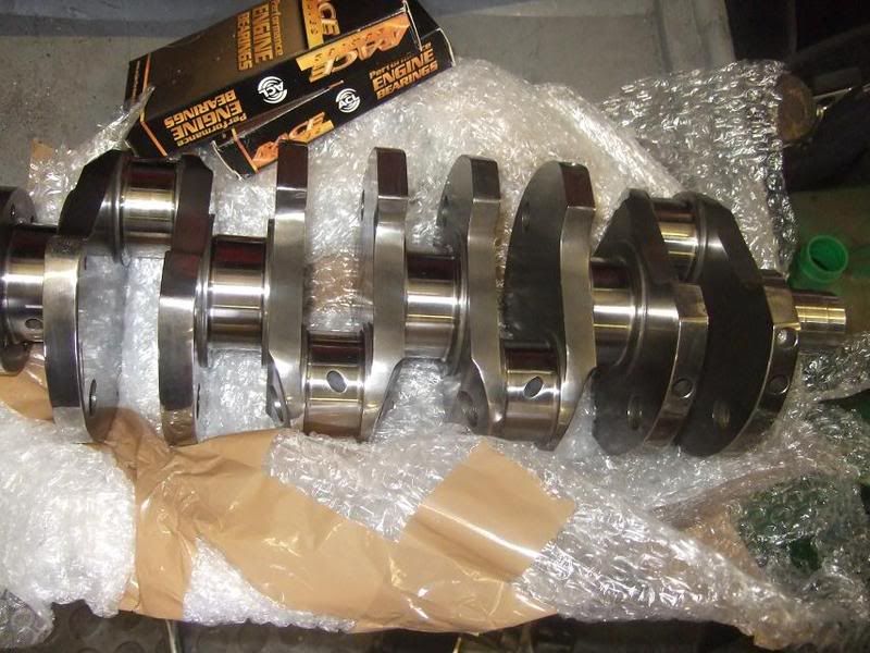

STEEL BILLET CRANK - £2K

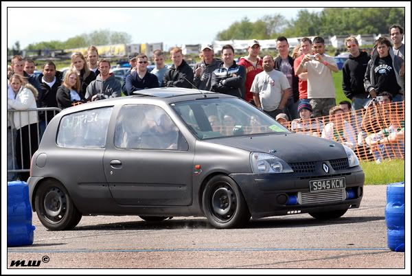

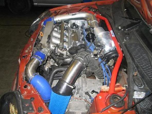

I was driving the 400hp clio ( black with 1.8t ) i know it wasnt a vw / audi and i got a lot of stick but it did have a VAG heart ;)

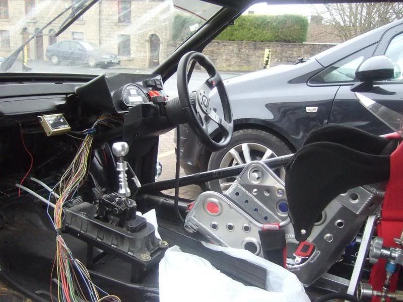

Just been round to look at Jordy's Rocco (we have a mutual friend).
'Tis really an awesome beast, but still a Mk1, running a floor pan, not a body on a tube framed chassis.
