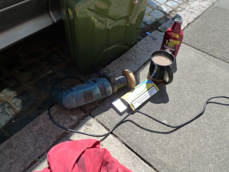

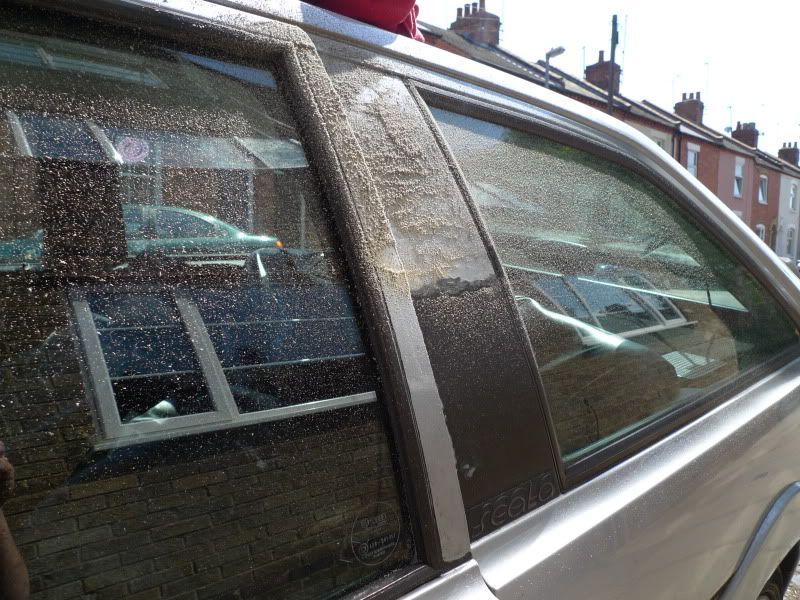

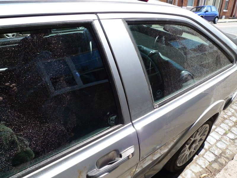

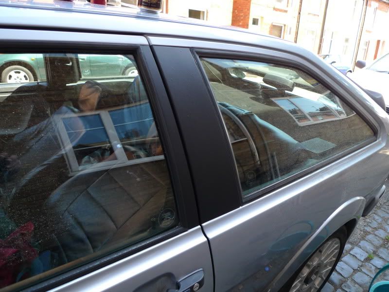

I used the toffee wheel that Jim kindly lent me to do the vinyl on my B-pillars.
First, get the necessary tools together:
Half way there:
All done:
New vinyl fitted:
Right. Good as they are, don't expect the toffee wheel to be a miracle cure. It's still bloody hard work and it still takes ages. Also, I cannot overstate how much dust the process creates. To say "it makes a bit of dust" is like saying "Katy Price likes a bit of publicity". And, as Jim reminded me, be gentle with it. It may just be a rubber disc, but it can (and will) take your paint off if you press too hard with it. Best technique - moderate speed on the drill (about half throttle on my Black & Decker) and "bounce" the wheel off the surface (gently).
Hard work, but worth it in the end.
