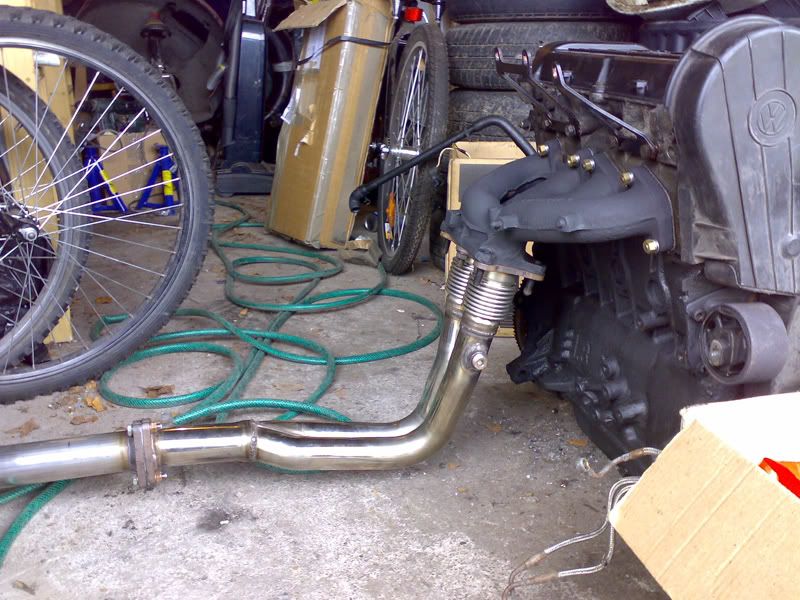

birdy, is that a standard golf 16v exhaust manifold your using? i'm not too keen on going the 4 branch route after reading about most of them suffering from cracking issues.
Re: 16v KR into GTII
Yup its a standard kr exhaust manifold but the key to being able to use it is the downpipe.
I'm using a techtonics stainless downpipe that allows me to keep a standard manifold, the downpipe can be found here http://www.techtonicstuning.com/showpar ... um=251.223
Not a cheap piece of kit, cost me the best part of £200 to get hold of and i think i'm either the 3rd of 4th owner!! So i would consider using a 4 branch conversion manifold! I know i'm tempted to swap over to one

Birdy wrote:Yup its a standard kr exhaust manifold but the key to being able to use it is the downpipe.
i'll probably just get my mate to knock me up a down pipe then, now i know the KR mani can be used
