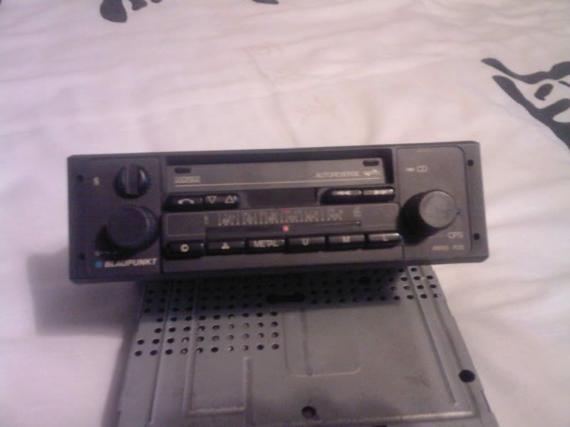

Right I have this stereo:

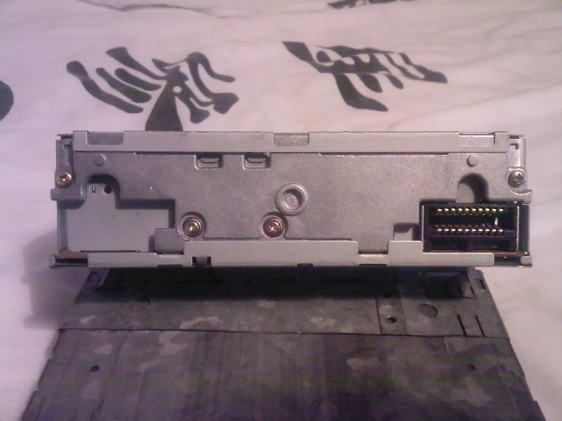

It's a Blaupunkt Paris R25. I currently have a Panasonic D50e. This is a picture of the back of the current Panasonic:

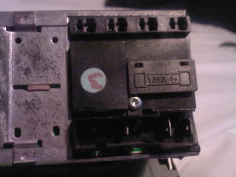

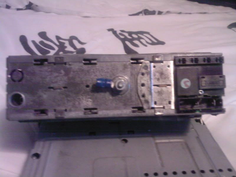

And this is a picture of the back of the Blaupunkt that I want to put in:
So how on gods green earth do I do it? Adapter? Or am I going to have to get the relevant plugs and cut/solder the wires to attach the new plug?

WTF that is old school! I'd guess the four pairs of connectors along the top are for the speakers and the three pins at the bottom are for power...And the bottom left connector will be for the aerial. I don't suppose you have the original manual for it.....?

well you've got spades for power and then you need some din speaker plugs like these
may be a bit of trial and error working out which speaker is which
the bolt in the middle needs to be earthed, make sure you connect an inline fuse to the power connection
