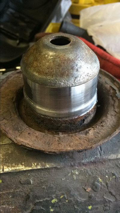

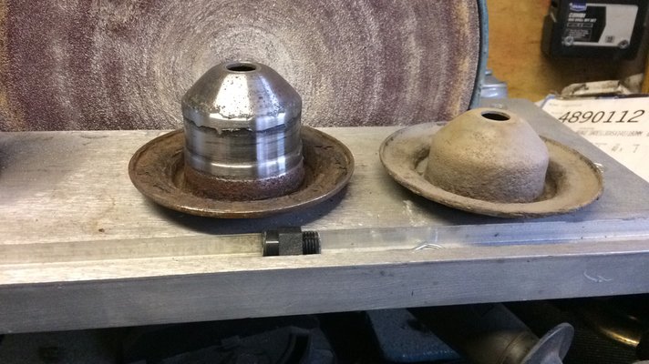

Post by james butler »
standard springs are too high
lowering springs start at 40mm and are too low.
eibach springs with 20mm added to the spring cups gives me 20mm lowering which should be about right and gives 20mm more shock absorber travel before botteming out which eibachs have a habit of doing to shocks

duggers wrote:Just before I sold my 16v rocco the standard springs needed replacing (one broken on the front-bugger!) and I found some 25mm lowering springs which worked well with standard springs just trimmed the bump stops to suit.
i did cut the bump stops but it just proves that the ride is too low for the current dampers and will inevitably lead to damage hence why i made these.
