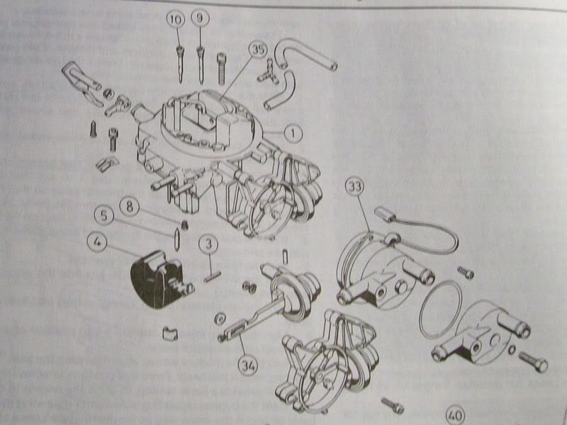

sorry it's a photo not a scan, having trouble getting the scanner to work properly. the jets are numbered 9 and 10

I thought the jets where burried in the carb, maybe they are in the bgger ones? Look easy enough to get at, get stripping jimbob. If you need a hand you know where i am.

Cheers Nate, have to go to ikea and fill it with stuff now so I'll have a hoke at it later. What's easiest way to get them out, they look threaded in diagram. Is there a recess on top, or do you need to split the carb and screw from below?
Re: Poohberg on a Polo
i've only ever taken them out of the 2E2 and 2E3 carbs, but they are usually have a slot in the top. just unscrew them with a screwdriver. blast some carb cleaner down them and then blow them out with compressed air (you can buy it in a can of you don't have a compressor, but it's very expensive)

Jets out carb cleaner in them then airline blown through, not a blind bit of difference :dash:
